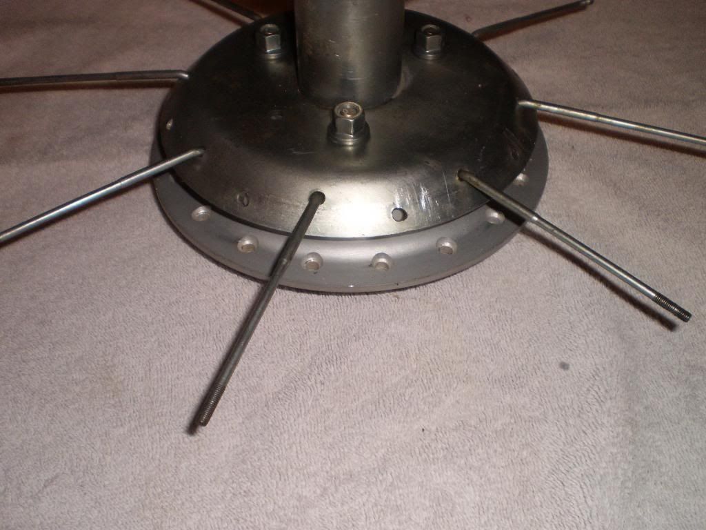

    Brian, take a look at the rear hub on his. The front brake drum on a stock TW bolts on to the hub, just like the rear. Same 3-bolt pattern. Except normally the rear drum does not hold spokes as it does up front.
    All that was done here was to lace the larger diameter front brake into the rear in the same manner as the front. Pretty slick, actually.
    You're correct, the engagement tab has to be shortened and the axle hole in the front backing plate needs to be bored to the same diameter as the rear axle. I'd be doing the same thing if I hadn't gone lazy mid-project. This pic shows a front drum bolted to the rear and the "normal" location of the rear spoke holes:
    Of course you wouldn't need to do this if you wanted to keep the stock rear rim. You could just bolt it on as I have in the pic. But it's a pretty good way of dealing with the different front/rear spoke count issue when swapping rims.

    Hi Russ,
    I understand the what he did on the brake side.
    However, as you know, the stock TW rear wheel has a different spoke count than most wheels (fewer - maybe 32?) Take a close look at both the inside and outside views of the sprocket-side hub. There appears to be a regular spacing of open spoke holes. A regular TW hub on that side should have too few spoke holes or at least be filled up. Why would there be extra spoke holes and how would he have gotten a non stock hub on?
    What am I missing?
    Brian
  10. #9
    Senior Member lizrdbrth's Avatar
    Join Date
    Jul 2010
    Location
    Desert, SoCal
    Posts
    7,369
    Wow. Good call on that. The math calls for a 34 spoke rim.
    I thought I'd just killed a fat rat for the LSR bike.
    Now I gots to know. Maybe Dubya can count some stuff for us.

    Quote Originally Posted by lizrdbrth View Post
    That is exactly what I did with my wide front wheel. I used a BW200 front brake on a modified TW rear wheel, leaving the TW spokes intact.
    (Sorry about the thread hijack . . .)
