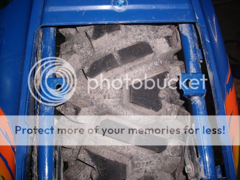

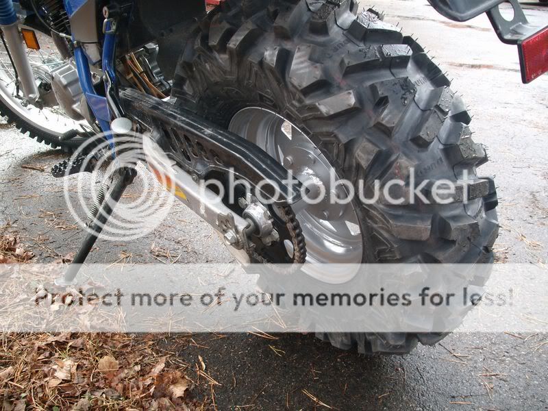

Tubeless goodness!  A 12 x 4 trailer tire, a custom hub, a Duro 25 x 8 x 12 tire and a lot of cursing trying to make the brake drum fit.
Bead seated at 25 psi.  Nothing blew up.

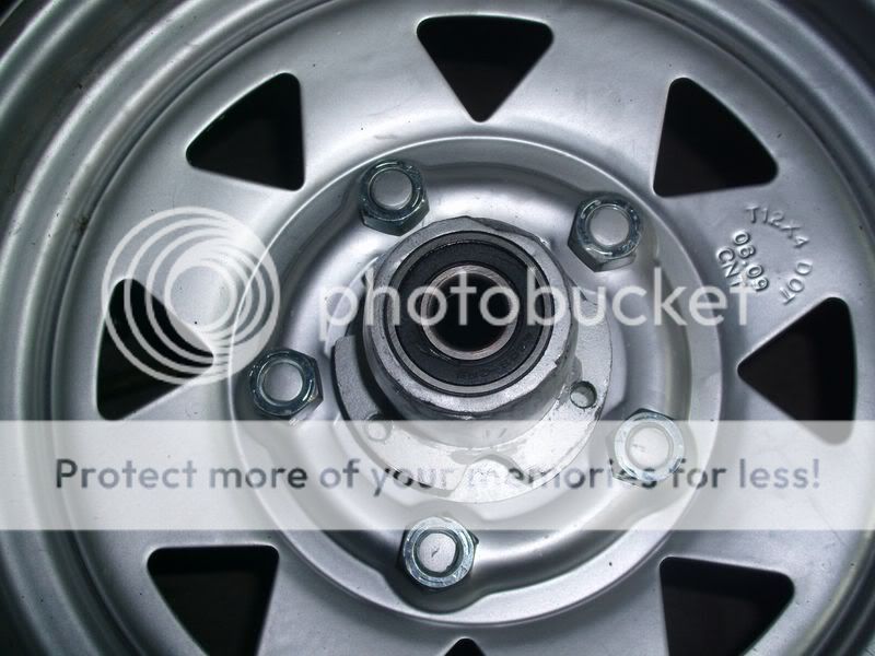

The Axle, sprocket flange and wheel flange are pretty straight forward.  Lots of turning and drilling, jig it up and weld it. All made out of mild steel.  The brake drum mount was difficult.  The maximum diameter that the wheel center can be turned to is around 3-1/4".  I ended up with a 2 piece mount, and a slight clearance of the brake drum to clear the mounting bolts.
I'll take it back off and take some pics after I run it around a bit.
If You're thinking about building one, the 5 bolt rim will allow a large enough center hole.  I don't think the 4 bolt rim will work.
A 14 or 15 inch trailer rim will work also, but the rim will be a lot heavier and the tire choices are much better in 12".  If you completely destroy a tire halfway up the Dempster highway, you could probably get a spare off from the next trailer coming up the road and make it home.
I used 2-1/8" OD DOM, 1/8" wall thickness.  Turned bearing cups independently, used the center spacer as a depth gage to jig the cups into place and weld.

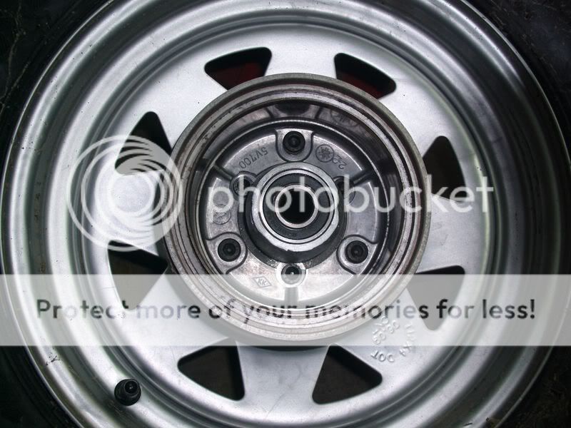

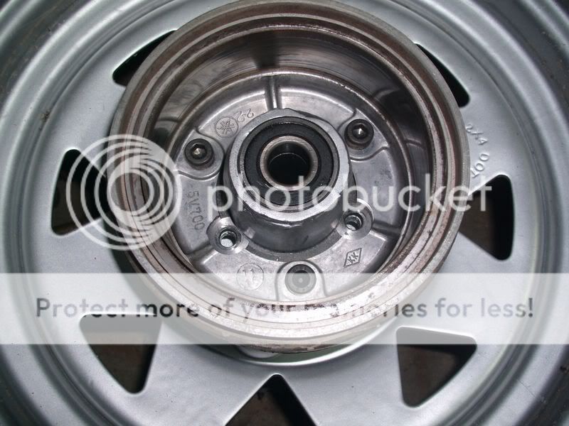

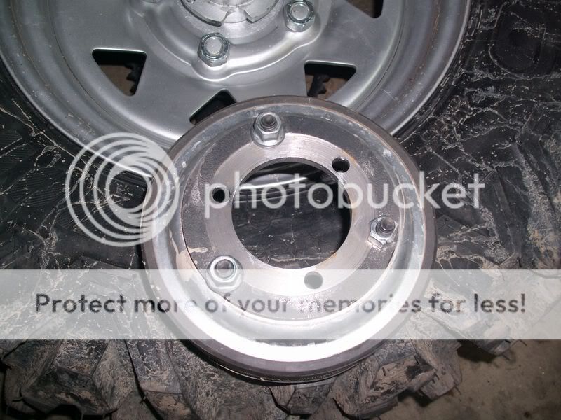

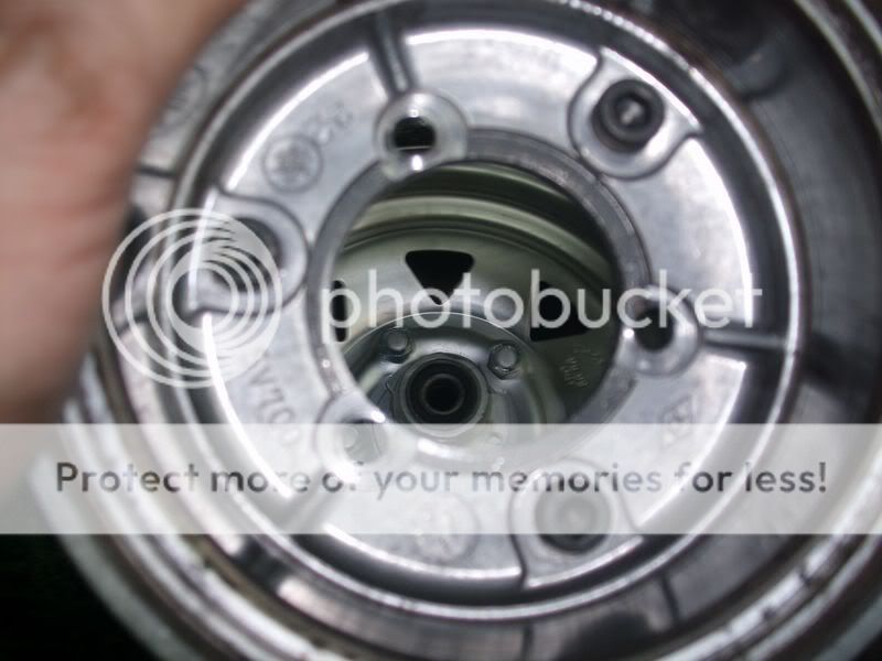

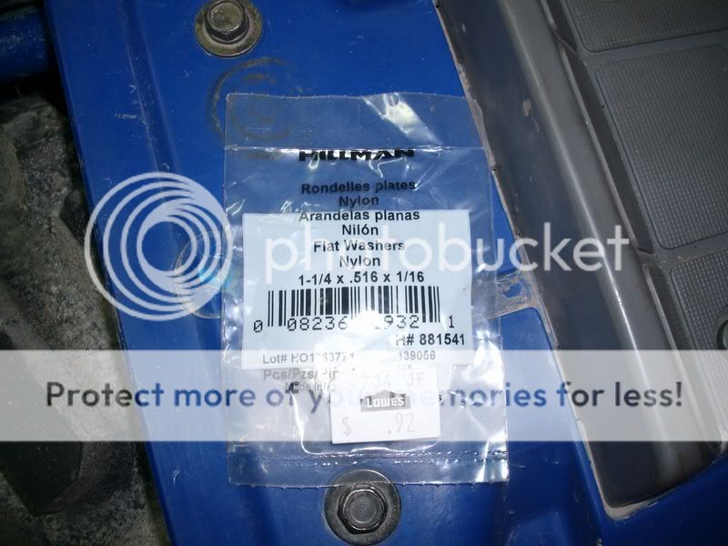

The center 3 bolts attach the sub plate to the hub.
This part of the hub needs to fit through the center hole in the rim.  You shouldn't remove enough metal from the rim to cut into the bumps around the studs.  That area acts like a giant belleville washer when you torque the lugs.
Blurry pic of area that needs to be clearanced on the brake drum to clear the center bolts.
Sub plate attached to drum.
The Tire, Brake drum, sprocket and hub weigh 42 lbs.  The Equivalent stock pieces weight 32 lbs.  5 lbs of the weight differential are the tire.  It's a 6 ply and it's hefty.......

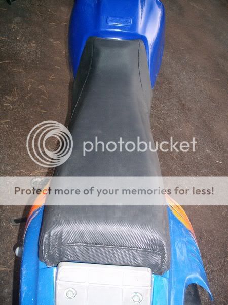

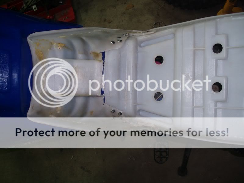

Threw a Banshee shock on and added a Clarke XT350 tank.  Went the "ELDAVO" route.
Turned out to be easier than I had expected.  Cut the front of the TW seat pan off, splice on the front of an XT350 seat pan.
Add some padding under the XT350 foam to match the TW pan to the XT foam.  The cover is an XT350 replacement.
Lots of stretching and stapling later, only the tail end is left with some mild wrinkles.  The XT350 foam is about 1 inch shorter than the TW pan, but it works.
No more waiting for a "maybe" TW200 tank, and I really dislike the stock TW seat anyway.  The XT350 foam is taller, giving a better seat to peg distance for me.

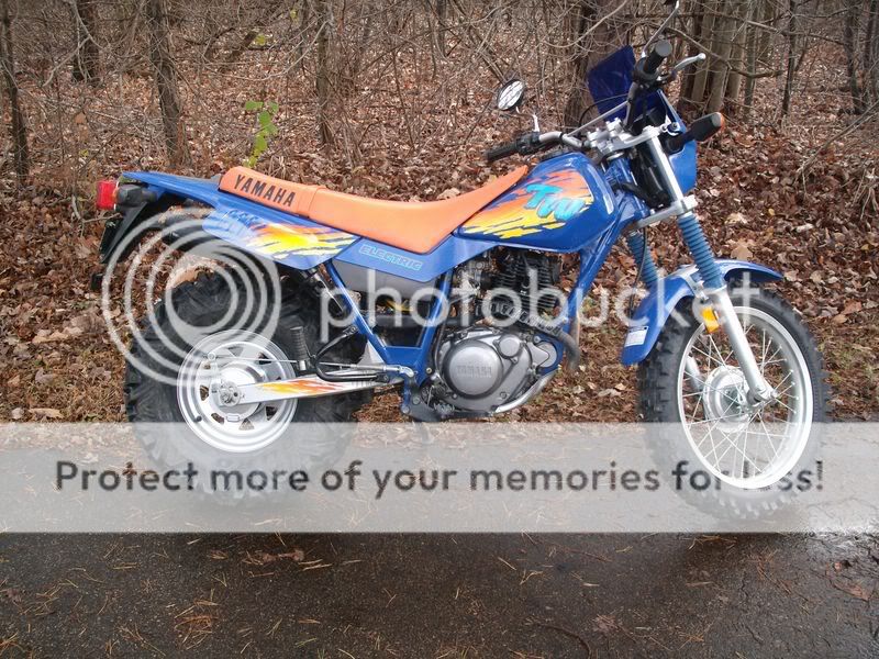

Not quite finished yet, but I took a trial run to see how the new front forks work.
Bored out a set of stock triples to 35 mm and fitted a set of Honda NX125 forks.  Made a new axle and put the stock rim back on.  Shows promise....

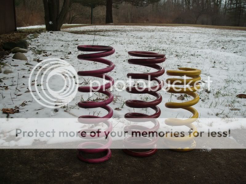

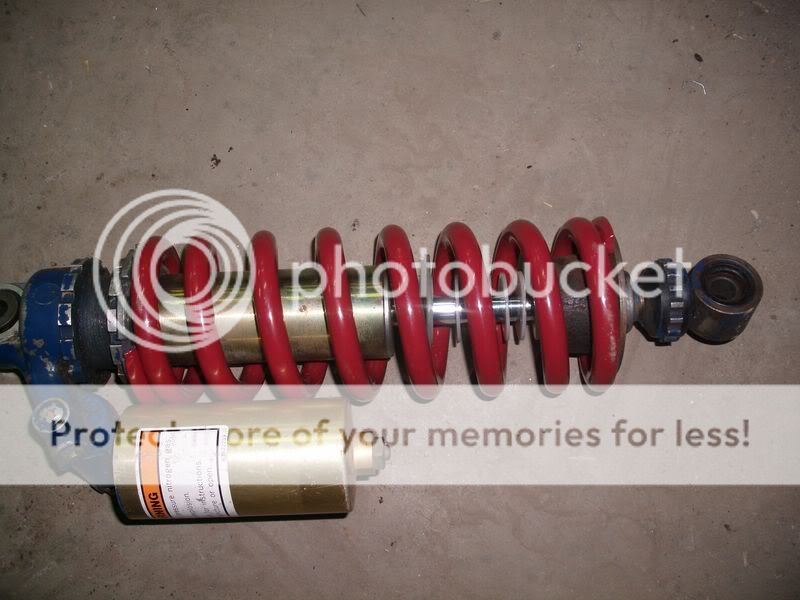

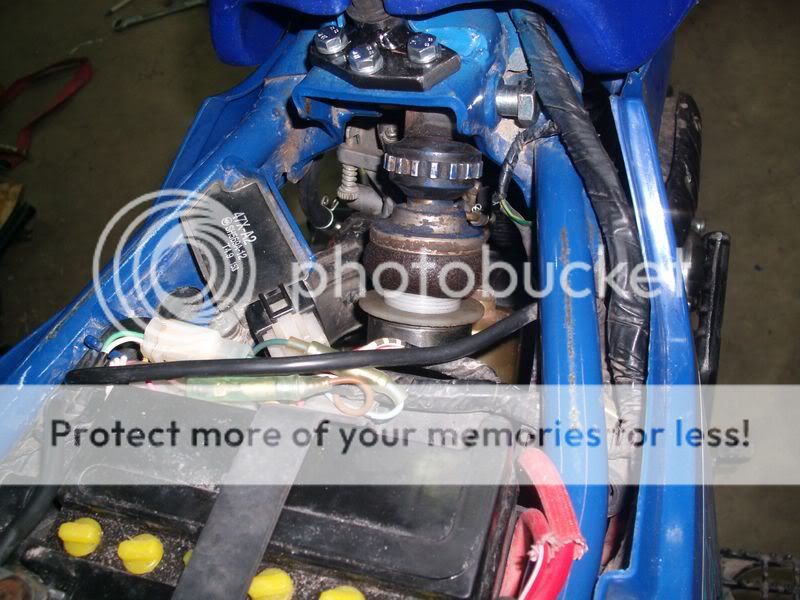

Rear suspension information:
A Banshee rear shock.  I started with the stock banshee spring.  The ride height with my 200 lb arse seated was only slightly higher than stock.  I could bottom the suspension on pavement by standing on the pegs and bouncing up and down.  Not good.  Pulled the spring and did some research.
Eibach Springs for Banshee- A Clicky Link
Stock Banshee spring on left, 450 lb eibach 2.25" x 9" in middle, stock TW200 on right.
Stock Banshee Springs are 6.8 Kg / mm, multiplying by 56 gives you 381 lb / in for the stock spring.
The Banshee spring is 56mm ID by ~230mm long.  56mm = 2.20", and a wide selection of race springs are available in 2.25" ID. 230 mm length = 9.05", and 9" springs are available in 2.25" I.D.  Off to the eibach catalog, and I order up a 450 lb / in 2.25" x 9" eibach spring.
450 lb / in is not really enough.  Harder to bottom on road, but pretty weak.  With preload turned up full, and ~ 8.5 " suspension travel, static sag is 1.5", loaded with rider only sag is 4.5".
Back to the Eibach catalog for a 600 lb spring.
With about 1/2 of preload adjustment, static sag is 3/4", 200 lb rider only sag is 3.5".  Suspension travel is about 8.5".  Close enough.
Its snowy and cold here now,
 but I've ridden it enough to think that the shock can be tweaked to work acceptably with the spring rate.  The Rebound adjuster seems to have been too stiff for any practical purpose with the stock spring, and turning it up some ends any pogo action.  I don't expect it is ready for supercross action, but it will be fine for a TW with an attitude.
The 2.25" spring is a little loose on the bottom perch, but will work fine.  If I were doing it over again, I would probably use a shorter spring and machine a spacer / adapter to more closely retain the ID of the spring on the bottom mount.  This spring has a 4.5" range of travel, and the banshee shock travel needs to be restricted to around 2-3/8" to try to keep the tire from bottoming in the frame too hard.  The Stock TW spring would probably work ok with a spacer, but I suspect that the static sag will be a bit much with the dual rate spring.

Split some nylon washers like these:
And add them below the current stroke limiter to help prevent any bottoming.  (The spring is off to measure travel)
 Eibach part # 0900.225.0600 is the spring I ended up with.  You can get them a variety of places, Summit racing has them for ~$75. I think any 6-9 " 2.25" ID spring in the 500 to 700 lb/ in range could be made to work.
A piece of trivia for anyone playing with suspension stuff:  Using crude measurement tools and sometimes guessing, I come up with the following:
20.25" from front swingarm pivot to rear axle (on #7 adjuster).
5.5" from front swingarm pivot to theoretical centerpoint of shock mount on swingarm.
20.25" / 5.5" = 3.68 : 1 motion ratio
Comparing the travel limiters I put on the shock at 2.375":
2.375" shock travel x 3.38 motion ratio = 8.74" travel.  I've been claiming ~8.5", could be 8.75".
I therefore proclaim the motion ratio to be kinda sorta 3.68 : 1.
This might come in handy if your shock guy asks......   :)
