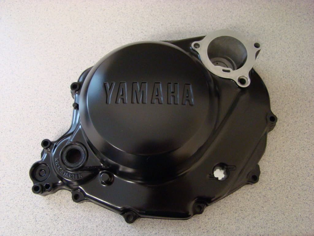

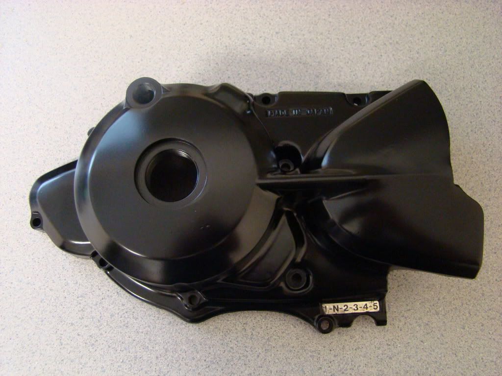

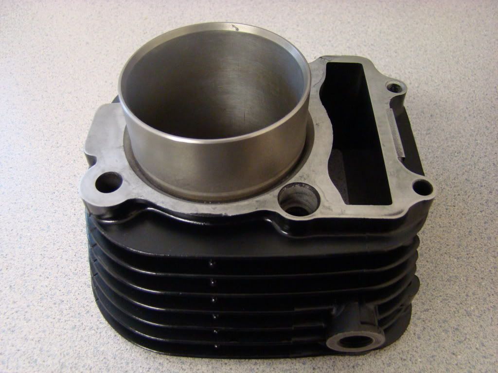

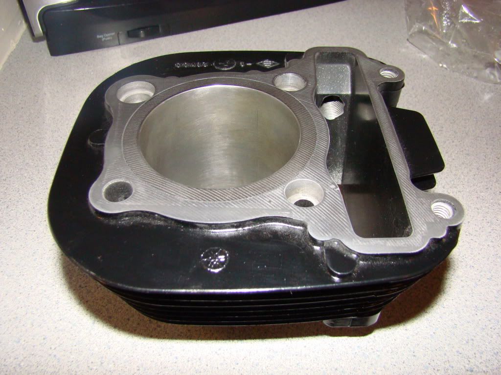

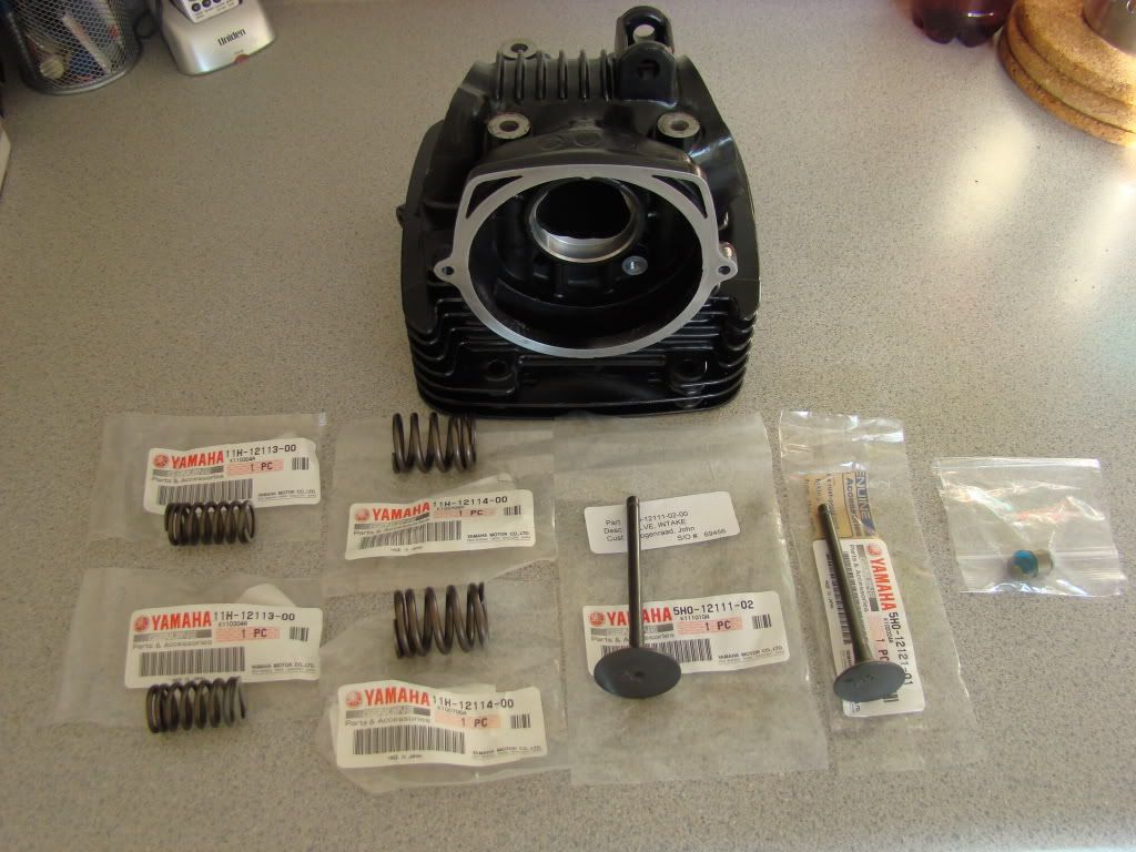

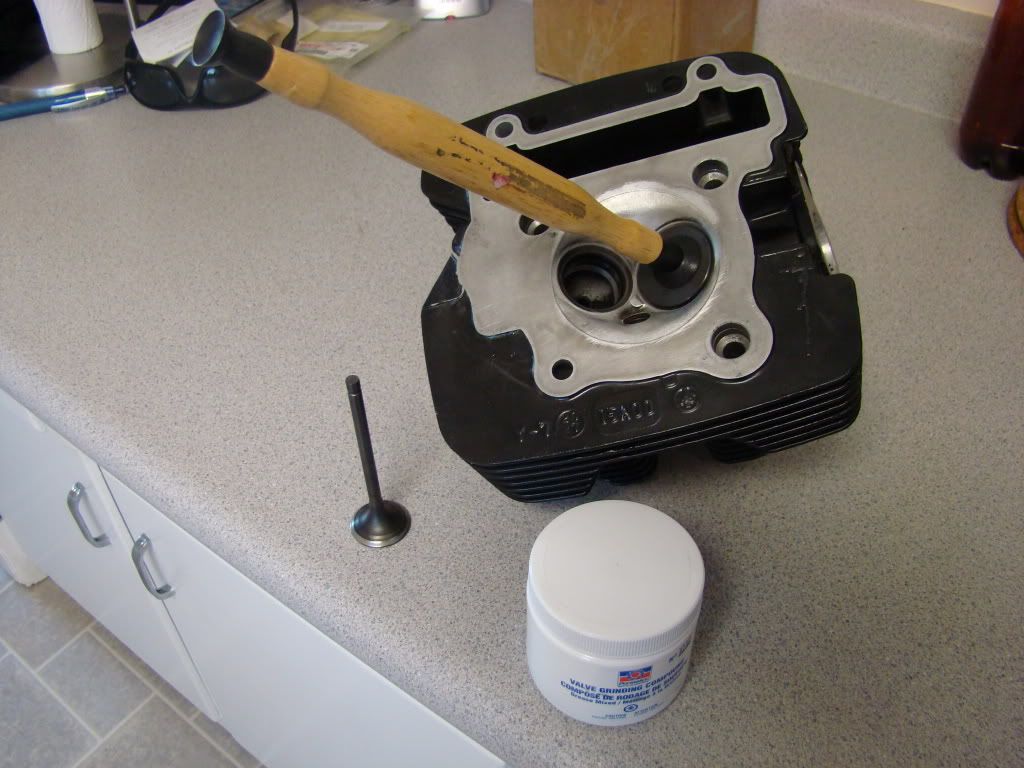

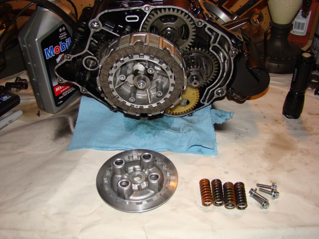

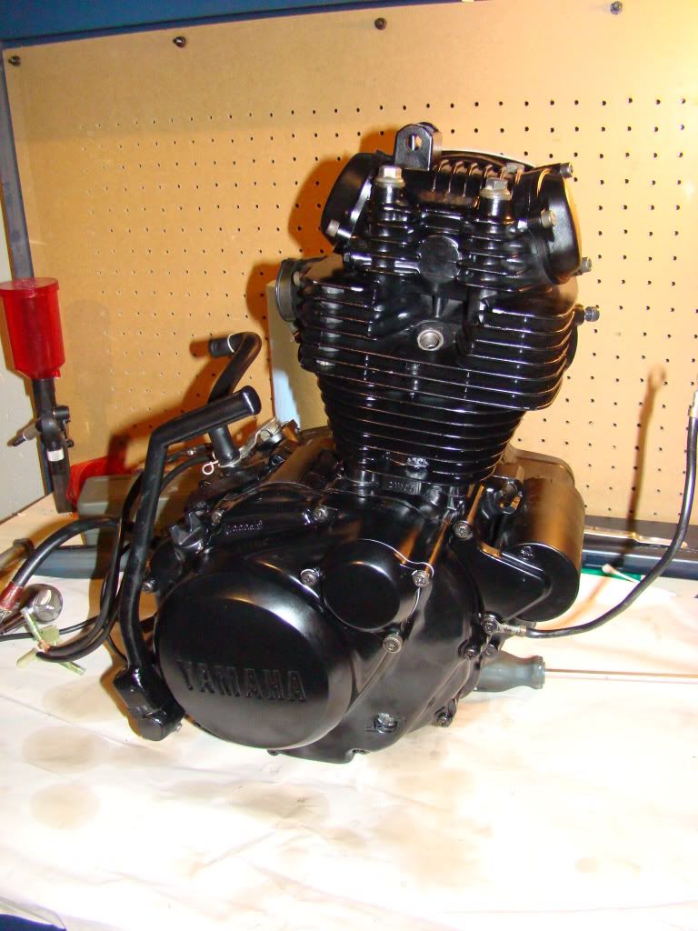

I put my 1987 T-Dub away for the cold season and wanted to freshen up the bike for the next riding season. I took the top end apart as well as the left and right side covers, bead blasted and refinished the parts. New valves, springs and seals on the head. Put a new set of rings on the piston after I cleaned it....was well within spec. The cylinder got a glaze breaking hone to clean it up as well, within spec. The bike only had 9500km on it but bieng 25 years old I wanted to give it a fresh start. Phase 1 (eng) complete, here are the pics!!!
64 Posts
Discussion Starter #4
Oh yeah, I threw in a new clutch, springs and set it up in a mint fashion! lol. Pics added.

6,057 Posts
Hey Hoogie,
What kind of paint(?) are you using on your engine? It looks like you're getting a better than factory finish!
Brian
64 Posts
Discussion Starter #9
Its called VHT High Temp Caliper Paint (CSP739 Satin Black) 900 deg F / 490 deg C. The company is out of Cleveland OH and should be available down south as well, I bought it at Canadian Tire.

Dude what is wrong with you? Your shop is cleaner than a hospital room. I need you to come and work in my shop for a while. ;-) Have a look at your cam chain guides while you are in there. They seem to wear fairly quickly. Did you go with a stock clutch? Excellent work!!!

whoa lapping with that suction cup totally sucks. You get it going and then the suction cup falls off over and over again. I rebuilt many motors but cheated. I put the valve in the head and got a small piece of tubing and put it on the valve top end. Applied some lapping compound and then put the other side of the tubing on a cordless drill and lapped it in and out on a low speed. Never came off and got it done without getting arm pump or tired in a quick time. Oh we also after cleaning the head used a japanese sharpening stone on the head to clean it real good.

You did goooooooooooooooooooooooooooooooooooooood. Now take fine sand paper and do the edge of your fins... That always looks cool.. What's step 2 ? OMM.
