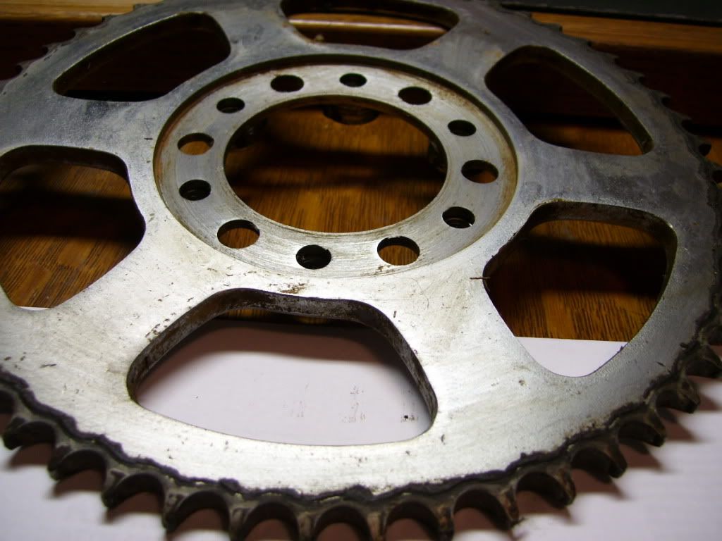

All the sprockets I run are manufactured by JT sprockets. I have always been very happy with the quality, however, they have a recess/thinner portion where the sprocket bolts to the hub. This will prevent the stock bolts from tightening down all the way as they will now not be threaded enough. I simply when to 3/8" grade 8 SAE bolts. You can use washers as spacers on the stock bolts as well. I have done it both ways without issue.
Remember as well, I am not a fan of the 45 tooth sprocket as I think it may still have you geared to high. Importmech uses a 47 and personally that is as small as I would consider, but the decision is yours. This is not the sprocket you would be buying, just shows you the center portion. Gerry
