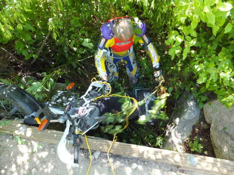

On my last ride with Mike I fell over and it took both of us to get it upright. I sure like customizing my rig, but at this point it is ridiculously heavy. I fear there is a good chance that I may not get it upright by myself. Here is my game hoist. I looked long and hard for something very compact. This unit really impressed me. And this is what I did with the hope of aiding a two-hand lift. Gerry

I remember a hoist thread on the old server. Guess it's time to re-hash that issue.
Yea, the nice thing about being around a long time seems to be, I now have a picture for almost every topic. I sometimes wonder if perhaps I am looking for a little 'to much' attention. None the less, the hoist is compact, well built and has a good pull ratio, though I have forgotten what it is. Gerry.
