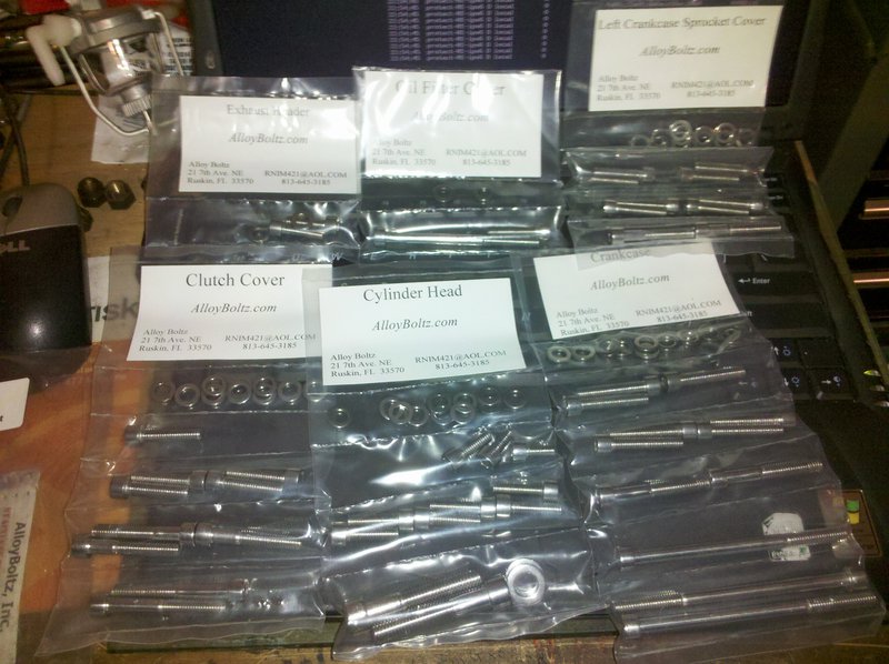

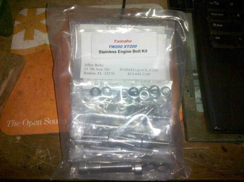

At a random poster's recommendation from a while back, I decided to go ahead and grab the ~$30 stainless allen head engine bolt kit off ebay.
My case has some of the OEM phillips head screw-bolts stripping and I'd rather not have a repeat of that later if possible. I'm not much for the 'bling' as the kids call it, but my jeeps manage to grow enough rust to keep me busy: don't need the tdub adding to the piles on the garage floor. Stainless is a nice option.
Disclaimer: I'm in no way related to or vouching for "alloyboltz" on ebay or elsewhere, but I figured I'd toss some pictures of the kit as I got it. Looks like fairly nice quality stuff. I haven't installed a single one of the bolts yet, and can't verify that they fit or anything else yet.. I'm sure you'll all hear from me if they don't (and so will the vendor)
352 Posts
I can give one opinion already: the "oil filter cover" set includes 2 bolts.. ours certainly has 3 bolts.
Now: what I don't know yet is if the stainless ones replace the two phillips heads, and the existing allen head stays. If your goal is to replace the original stripped screws with bolts, this is fine.. if your goal is shiny stuff, maybe some irritation to be found here.
I remember whomever posted about them before said that since it was a multi-purpose set, there would possibly be leftovers, as well. I don't argue with extra bolts unless they were in it when I took it apart. I have a few nice piles of them for later use!

I bought the alloyboltz kit via ebay and it works great for me. None have loosened and that was over a year ago. Make sure you use some anti-seize or locktite and don't over tighten. Correct, the kit only includes two screws for the oil filter cover, as the shoulder bolt is not included. The only discrepancy in the kit is the screws for the timing chain cover either are too long, or they don't come with the kit. I'm sure the long ones will work.
