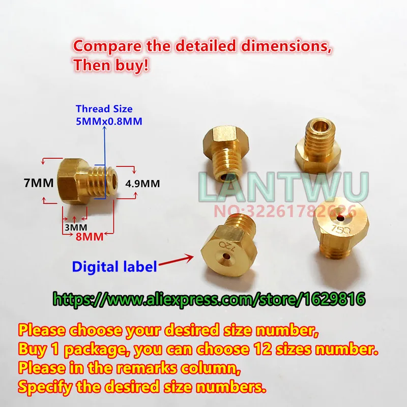

Anyways, gotta order me a few more pilot jets. I'm currently using #34 but stock is #31. Someone in an older thread pointed out that these should work;
Great price if they do, but the thread I found this on, the author never posted how they ended up working. Anyone know for sure they work on the late model TW's? Notice that the smallest size is #35 as well. Not a big deal I suppose. A little rich on idle circuit shouldn't hurt?
BTW, they also sell the main jets;
The price is incredible at $10.50 for 12 of the pilot jets and $10.90 for 12 of the main jets.
EDIT
I placed the order; $21.40 includes shipping. Estimated delivery 30 days, but who knows with China these days.
12 pilot jets at #35 (smallest they list)
4 each of main jets at #130, 128 and 126. I got the smaller ones because I ride anywhere from sea level to over 7,000'. The 130 works at all levels, but I get more miles out of the leaner jets at altitude. (Same with pilot; better mileage with the smaller 31 stock jet, but takes long warm-ups and there's a dead spot in the throttle slightly off idle until the needle jet circuit picks up that is much less with the 34 pilot)

I have used those jet on older style carburetors. They have worked very well for me. I have never tried them on the newer style carburetor. On the older carb I am using #40 pilot and # 112 main jet.
I gave some jets to friends having troubles with their bikes and these jets worked well for them too. Good luck. Report back how they work for you.
