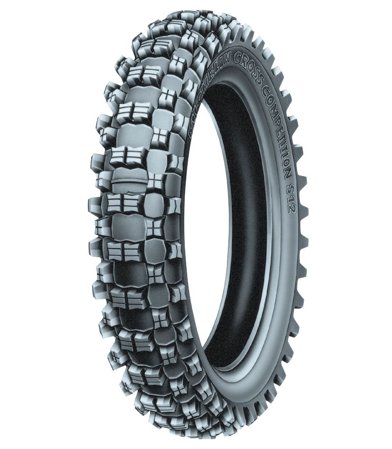

My favorite front tyre, for the realy hard offroad:
Michelin S12 XC -> 120/90-18 (it is a rear tyre)
-> Click to get a bigger picture
