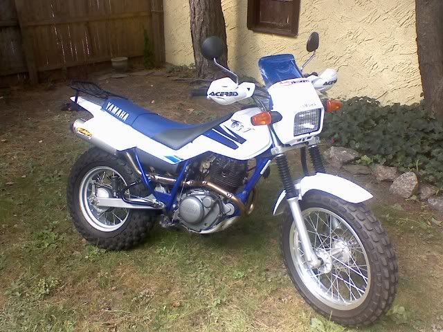

I had the luxury of having a parts bike with ugly plastics on which I could experiment with bedliner (rough dull black finish). When I first did the deed (I rolled and brushed it on instead of spray), I was not impressed. Prep is important in having plastic free of dirt, and oils, and decals. I had a couple of tiny places where the black stuff did not stick and the finish was a bit rougher than expected. However that said, the side panels were installed on the bike and any reservations about their color or texture were quickly forgotten. I rode with those panels for at least 2 years before in a fit of generosity, I shared them with a forum member who was doing some mods (and returned my white ones to my bike). Moral to the story, if I really wanted flat black, I might still do the truck bed liner stuff, or other flat black paint on any old plastic color, but only you can decide whether you are building a show bike or a ride bike. It certainly held up - I had no problem with scratches, peeling, or latent ugliness. Whatever ugliness it had was there from the beginning.
I have the rear plastic panel that I painted that I'd be glad to share with you or anyone else for the cost of shipping and a nominal packing/nuisance fee, if you see what the bedliner looks like or want one to experiment around with. The rear plastic is a bit large and hence would have to go ups. Or you can come to NM to pick it up and have it for free.
P.S. After posting this I realized that the photo in my signature line had the bedliner side panels depicted. Tom

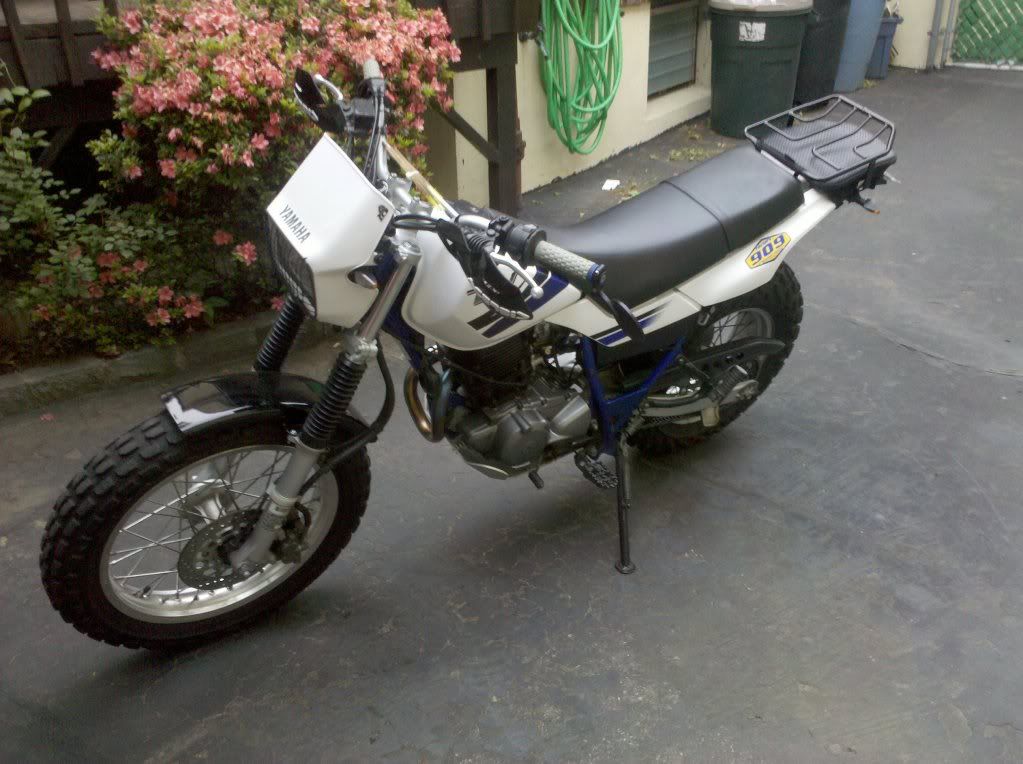

So far Im about halfway in my fade to black conversion.
I see kyosuke had a photo of his all black TW over on the General Discusion page.
FootDoc, My blue seat is largely covered by the WallyWorld seat pad, but the black seat is attractive. I'm assuming your conversion is a vinyl die job and not a re-cover. Correct?
Hey we all need to clear out our storage sheds sometime. Tom
Its actually a re-cover. My father was kind enough to have it done for me. Has a layer of memory foam that made tons more comfortable.
Here is the seat from another angle:
