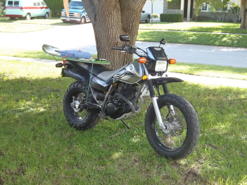

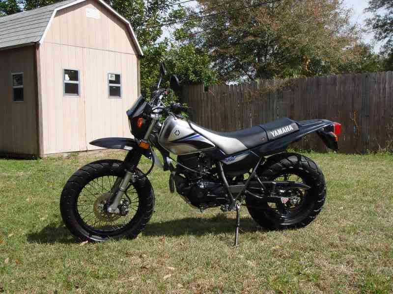

I am biased....but here is the supermoto fender I bought with the custom bracket I made (my neighbor made...I just supervised).
A side note, Cut off the corners (right angle corners) so it does not hinder the turning radius.
