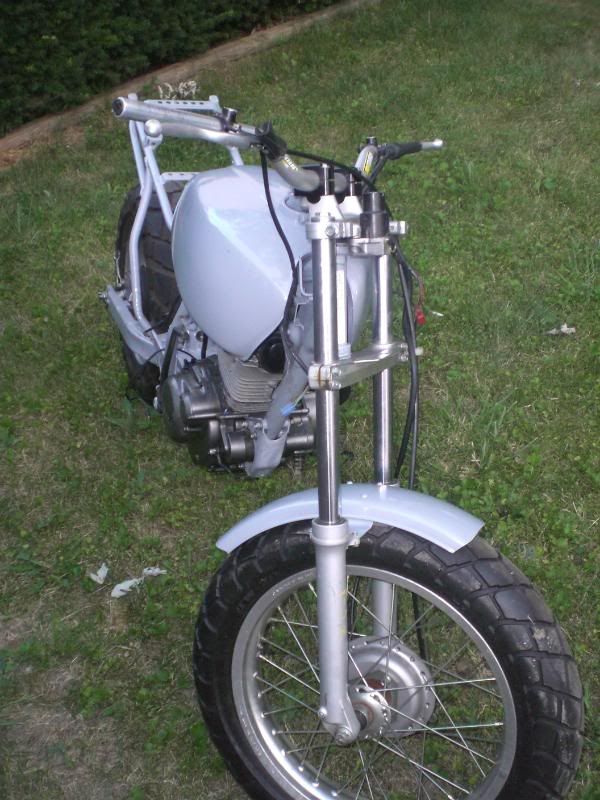

I'm seeking some feedback and suggestions on additional mods for my t-dub. From seat design, to exhaust set-up, and anything else. Just moved from the midwest to NYC, so I stripped an off-road king down and made a city bike with a ton of gas space.

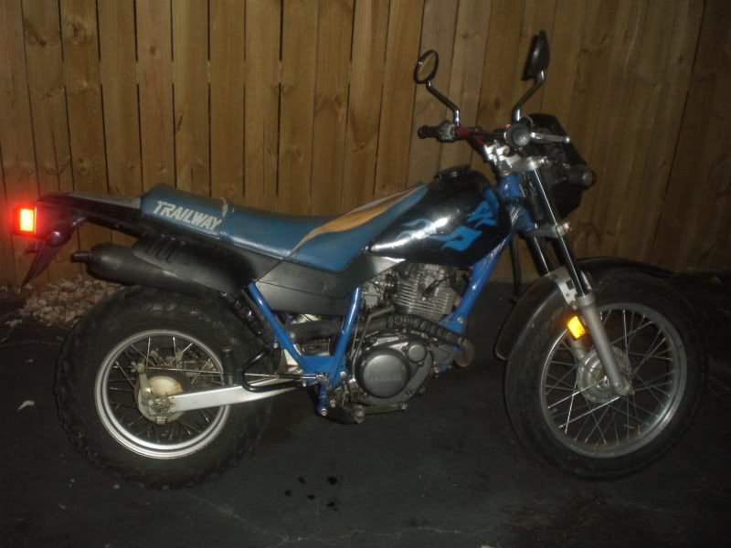

My '89 TW before

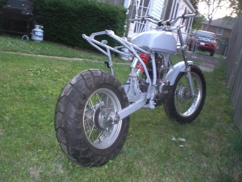

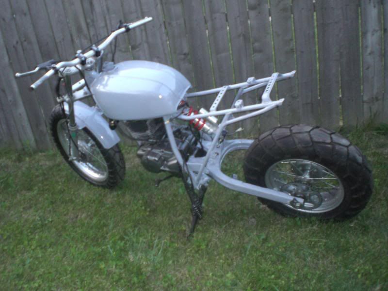

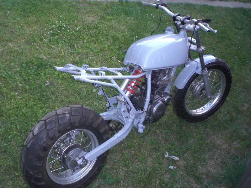

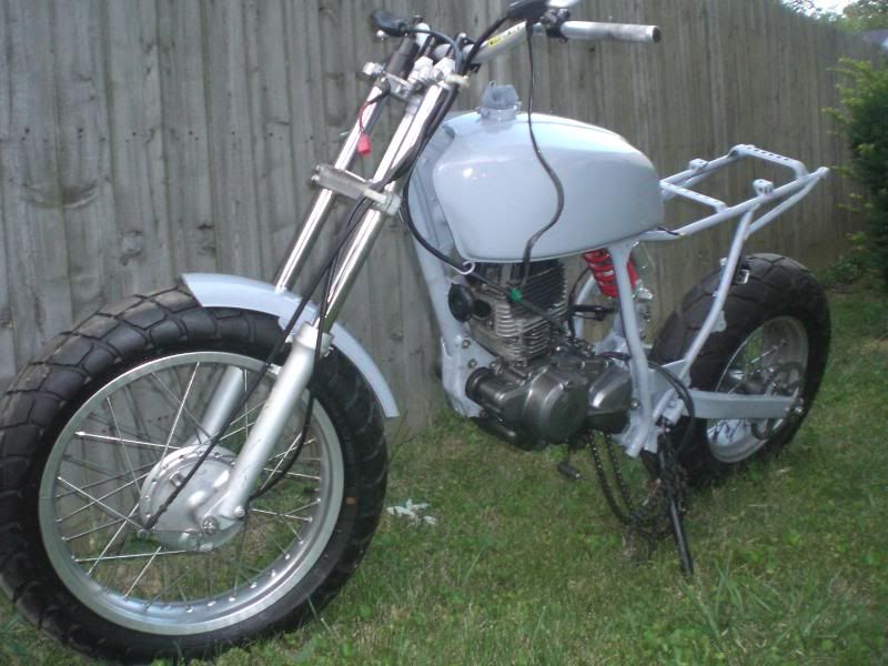

My '89 TW after:
- AF F-16 gunship gray paint match
- 3" swingarm stretch
- Bridgestone TW201 / TW202 tires
- Custom battery tray (not pictured)
- R1 Shock + custom mounting
- Pro-Taper handlebars w/ mounts
- 1972 Suzuki GT750 "Water Buffalo" tank
- Custom front fender cut from scrape yard find (70s style - bike unknown)
- Custom rear fender mod from a scrape yard find (70s style - bike unknown - not pictured)
I customized a single point headlight mount and have a 7" chrome headlight needing to be installed.

The Water Buffalo tank is clean, came with the original cap, and was cheap ($10). There's a great jap. bike scrap yard in Columbus, OH called Rice Paddy (http://www.ricepaddymotorcycles.com/). They have a bins of tanks, fenders, and such ripe for mods.
It was also a breeze to make fit to the frame (minus the TW seat).
1. Trim some of the rubber on the front TW mounts.
2. Cut approx. 1/2" off the top of the rear bolt mount where the TW tank was bolted to.
3. Make 2 simple brackets to hold the rear part of the tank down to the frame.
4. Drilled 2 small holes in metal on the underside of the tank to attach the brackets to.
The more complex, but not too challenging part will be making a seat to fit nicely.
TW's have such a short tank, it's tough to find a good tank to mod to the frame. Here's some other tank ideas I sampled:
70's Yamaha RD350 or RD400 tank
mid-70's Honda CL360 tank (this tank was too nice to mod, so I sold it)
'82-'83 Yamaha XZ550 tank
I even tried an early 70s Hodaka dirtbike tank & a late '67 Wards Riverside tank but the tunnels were too small.
