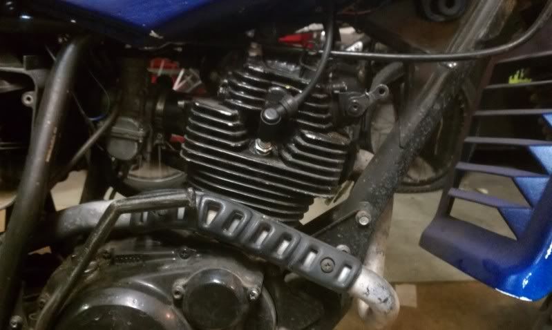

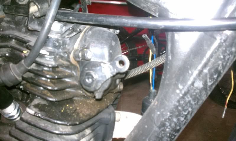

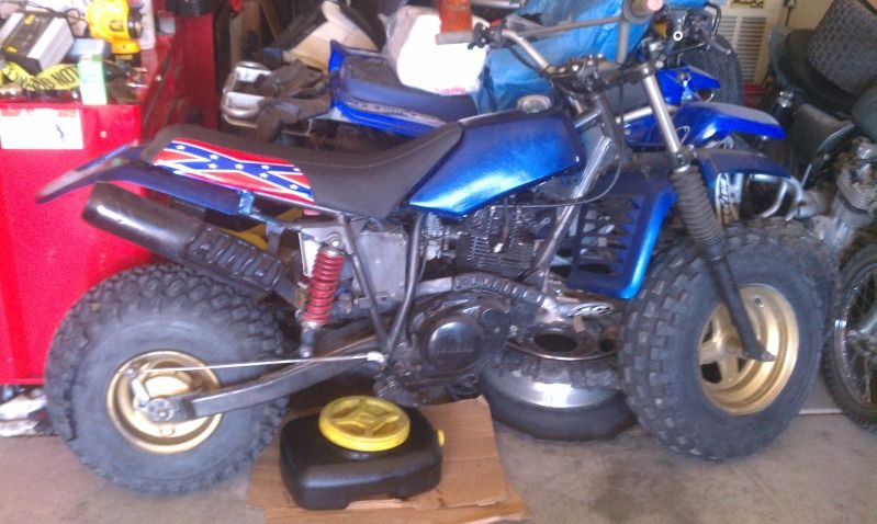

Sorry to necropost but I started a thread to get some info but I am realizing I should have searched more (rookie mistake). Macbig2k1, I am working on an '87 BW200 and I would like to upgrade the clutch and transmission to XT/TTR components, but I want to keep the kick start and factory compression release valve, as I am doing the YFB250 jug and 74mm sleeve from one of your threads. I was wondering if you could provide a list of the components I will need from the XT/TTR to make this happen. Thanks in advanced!
252 Posts
After doing some gearing calculations I figured out switching to a six speed would only gain me around 2mph on my top speed and not really change my distance between gears a whole lot, so I ended up just buying an '86 TT225 clutch assembly to make the stock bottom end a 6 plate clutch and called it good.
