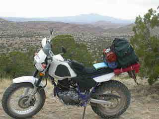

Matojo, Somehow we all manage to get a bunch of stuff on the bike with available racks, saddlebags and straps. Here's my admittedly conjured up setup. The top bag is a roller bag (perfect once reinforced because it has struts on the bottom, loops for tying on stuff, and with sleeping pad and tent against my back actually provides a back rest.
Whoops, I just realized that photo did not have the saddlebags so I'm tempted to add the following even tho the focus leaves something to be desired.
The first time I used it I attached it with heavy wires ties and had one or more break over a rough 150 miles. Now its bolted on with U bolts, and the struts are reinforced to the bag with a thin plywood liner instead of the few flimsy rivets provided for airline travel use. The wheels on one side detract from the purist status, but what the hay?
I love my Tourmaster bags and they stay on the bike at all times. The bike in non camping mode looks like this complete with the locking and moderately water and dust proof aluminum case.
