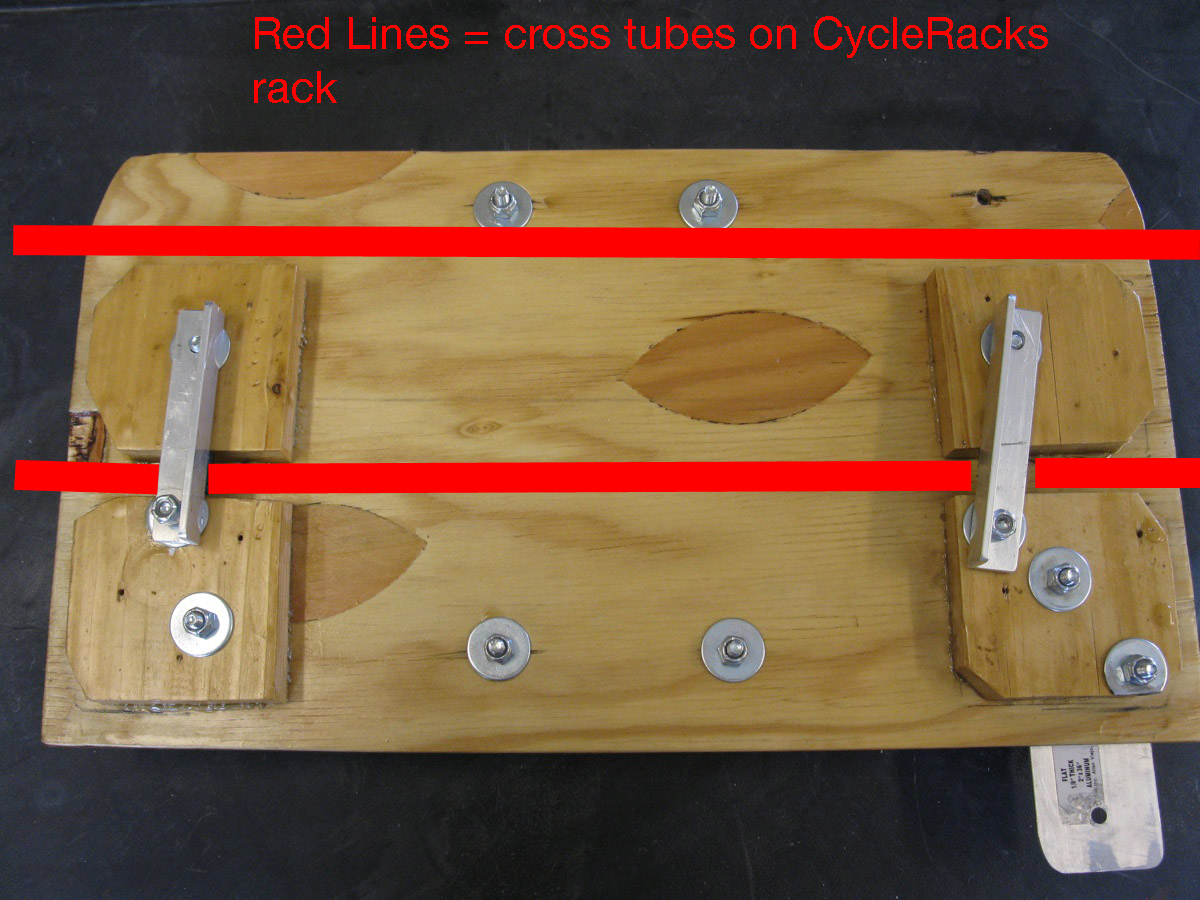

I began with a piece of 1/2" plywood, and added to the underside some blocks of 1/2" wood to fit in the spaces between the two tubes which run across the width of my Cycleracks rear rack. These will keep the rack from being able to move either side-to-side or front-to-back.
Then I cut and fitted some aluminum angle iron to span the captured cross tube and secure the plywood platform on the rack rack when we are bouncing across the countryside.
On the top side I bolted four pieces of 2" alum angle iron with pieces of old rubber conveyor belting glued on for padding. These are placed to hold the 5-liter can in place, and also to secure the ends of the nylon strap which holds the can down on the plywood platform. Next to it is a [third] 'Famous Storage Container' to hold the pouring spout and some additional tools.
Finally, my magnet-mount Marcee tank bag clanks into place very securely on top of the can. It is very secure and yet very easily removed when I want to carry it away from the bike [to eat lunch on the edge of a cliff, etc.]

Nice work, I am glad to see someone else using Quick Fists. Where did you find your 5 liter gas can? I have tried using a plastic Kolpin, but found that it leaks when I mount it on its side like your. Any problems with yours leaking?
