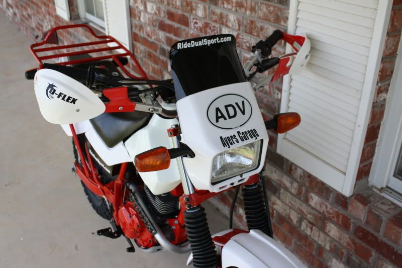

I really like my Tusk handguards but the logo was wearing me out.
Just an FYI, a little Acetone on a paper towel will wipe the logo clean off. It doesn't damage or mark the plastic and leaves them nice and shiny and BARE.

Thanks for the timely suggestion AG - I just put on my new set last night and agree with you, no need to advertise for both Yamaha and Tusk as I wiz down the trail. I tried your suggestions and, sure enough, the black logo came right off, just as you said. However,I was left with a grey shadow where the logo had been and additional light to moderate applications of acetone did nothing to remove it. I was finally able to remove the shadow with a dampened Scotch pad and then I polished up the lightly scratched guard with a judicious application of rubbing and then polishing compound. Looks pretty good now but it didn't really look THAT bad before.

Barkeeper's Friend will sometimes buff out the "shadow" without scratching the plastic.
