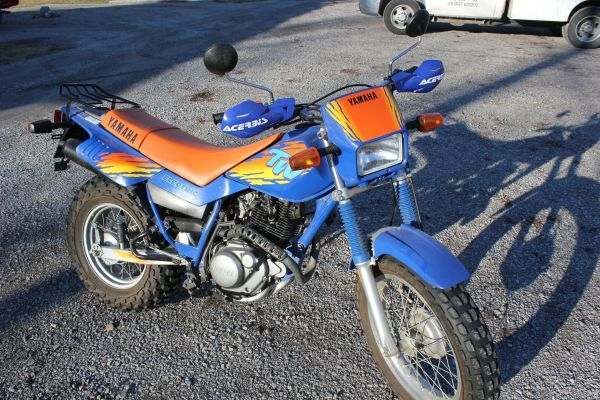

The usual 'before'� pic, as it was when I got it.

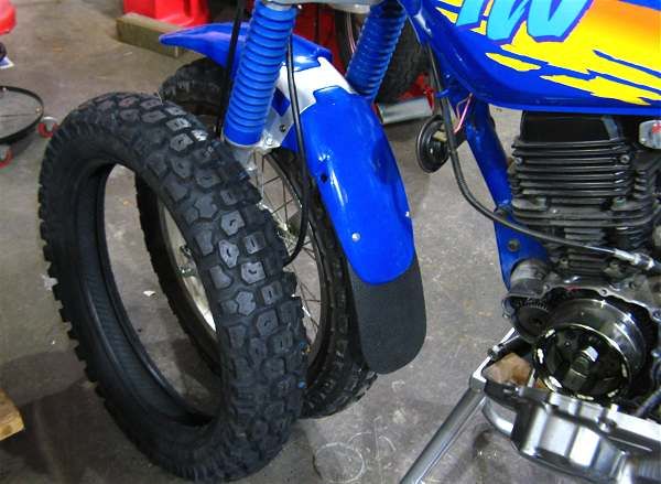

Made a mudflap, ready to mount the Shinko 244, and opened the side cover to change the front sprocket to a 15T. I also switched out the Phillips head screw to stainless Allen head.

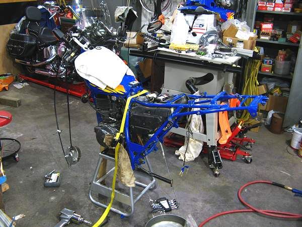

Took off the front end to inspect the forks, de-rust & paint the lower triple clamp, and switch to black boots. The swing arm had to come off too for cleanup and paint where battery acid had ate the paint off.

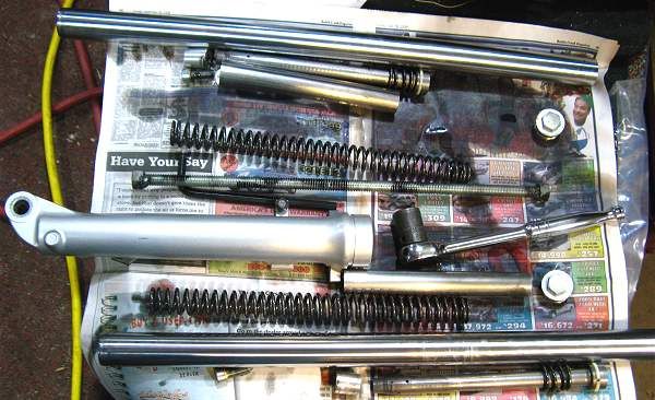

Forks looked good, for a bike that sat 18 years in an unheated Michigan shed. Thanks to the folks who posted the fork
'how to'� tech threads, the job was quite easy.

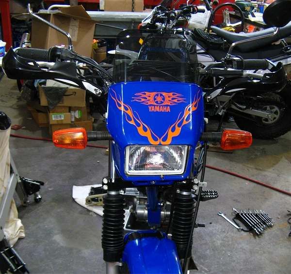

I didn't really like the graphic on the cowl so.....
I put on some ebay stickers and clearcoated them with Fusion. I'm keeping the graphics on the tank and rear fender so I picked something that sort of matched.
