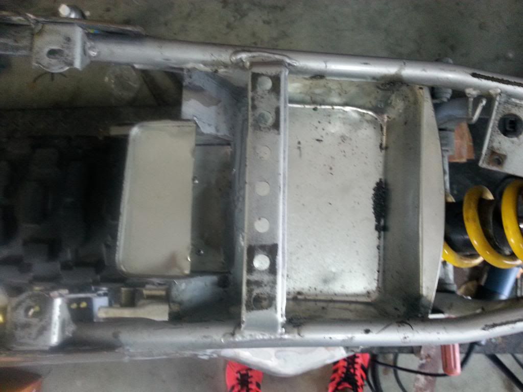

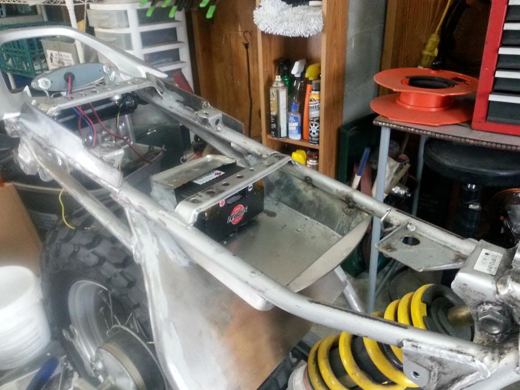

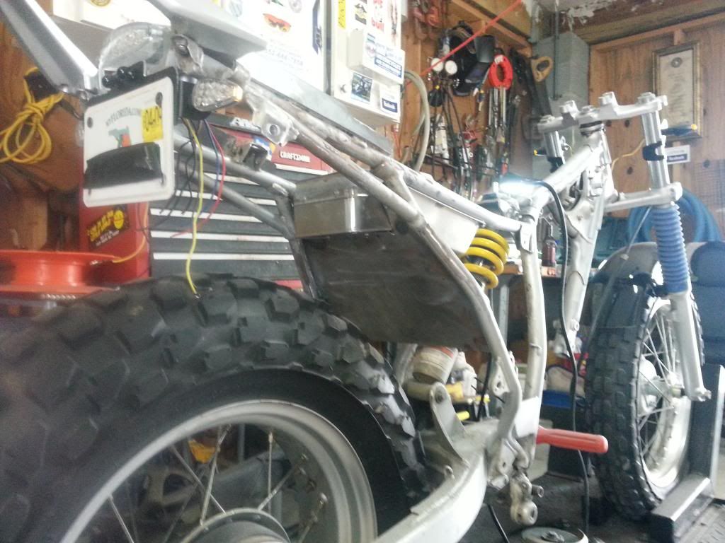

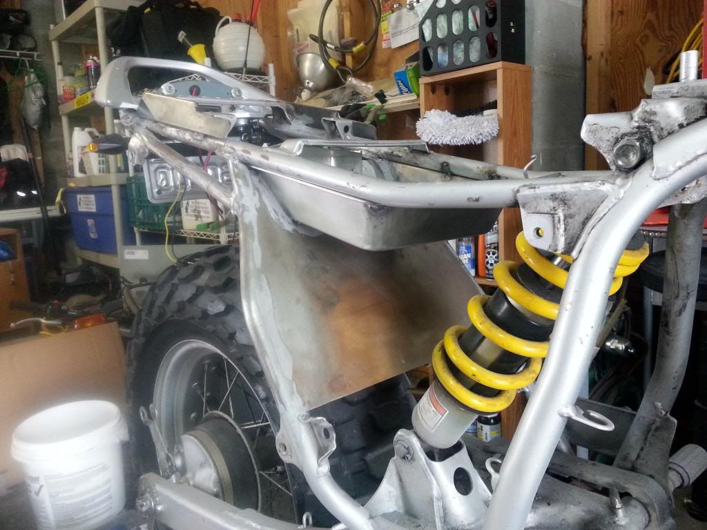

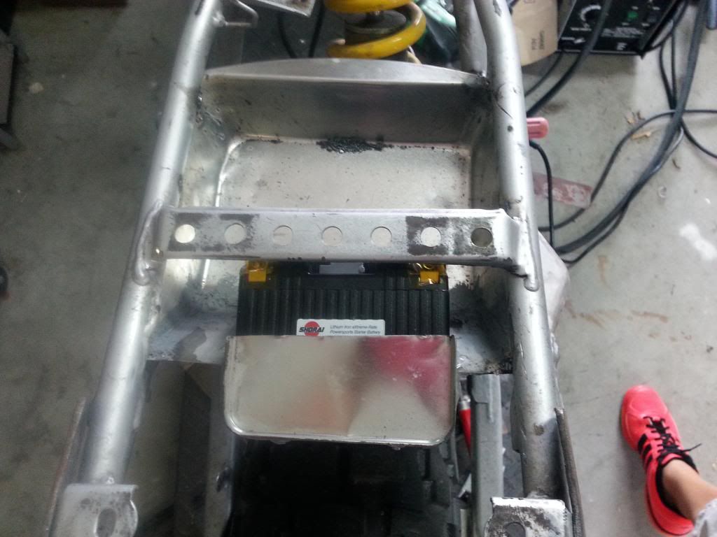

UDATE: With some free time at hand we have managed to finish up loose ends and prepare to send off to get powder coated. Home-made mud guard welded on (just sheet metal from home-depot cut to size) along with battery and electrics tray. Went slightly in a different direction with the actual battery tray part (see pictures) allowing more room for the electrics. Battery tray was made out of a tin purchased from Goodwill at 79 cents! Tin was cut in half so one section could be re-purposed as a lid (riveted together). Electrical tray was originally a baking pan ( 7 1/2 by 11) at a whopping $1.99 ... perfect fit! Still filling in some gaps with liquid metal by bondo. Once powder coated should appear seamless. Here's the results so far:

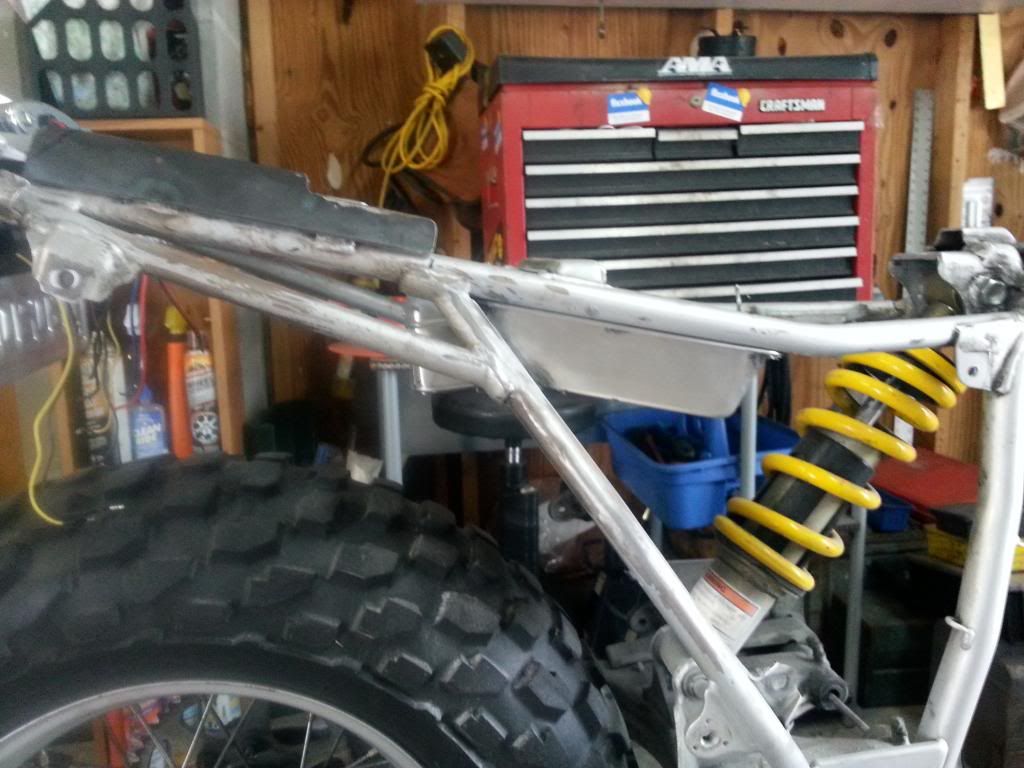

The other pieces of metal welded to the frame are to hide a tiny gap between the seat and frame (see picture). Just looked odd ... thanks to mattmus4357 for point that one out. Ordered a new head light (ebay $68) along with universal brackets (ebay $10). Wanted to keep brackets even (without bending inwards) so in order to do this had to jimmy rig some extenders using simple hollow pipe with long screws threaded through to attach head light. Brackets also accommodated turn signals. Here's the look:

Forgot to post picture of seat with the gap hidden:
Again once powder coated (black) should look as one ... grass hopper!!
