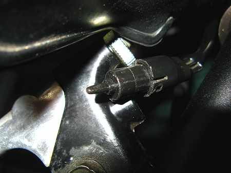

Here's pics of the one on my '98.
Square boss side

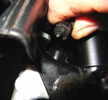

Opposite side
Late model (post-01) safety and brake switches have a bigger barrel than early switches. They both look pretty much the same but they aren't interchangable, they won't fit into your clutch or brake perches. Make sure the number for the old styles are not superceded to new style switches.
There's a rectangular window or slot that the little "ears" lock into, as Rainman described. They only fit one way. To remove them you depress the tabs through the window window something like a small screwdriver and they slip right out.

Ok, I just had to see what I was missing so I carefully took off the brake switch and sure enough, there is a tab to depress. It must have broke off the clutch side. I needed to know what it is supposed to look like. The bottom one has the tab intact. Curious George is happy now....problem solved & lesson learned. Thanks for bearing with me.
