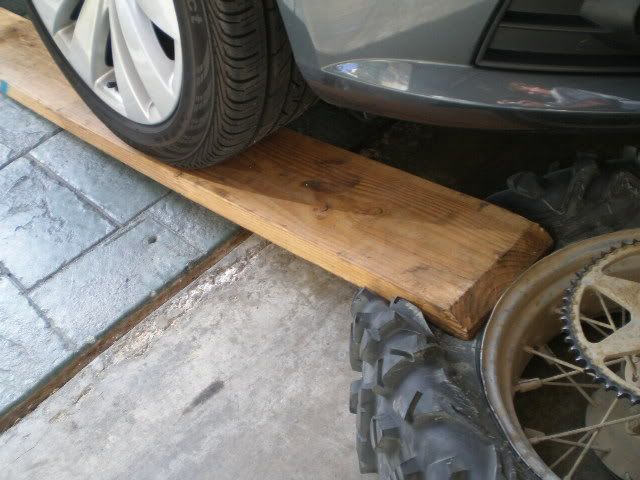

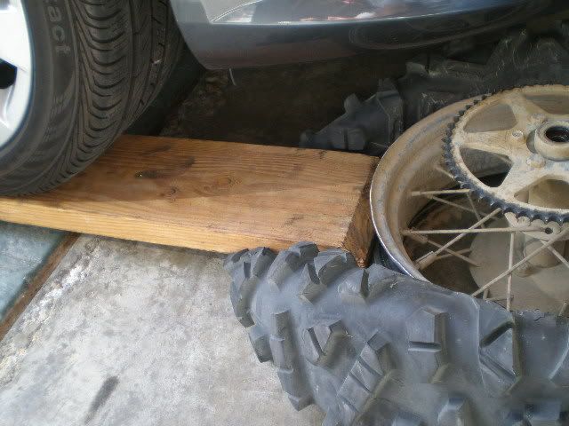

These Bid rear tires are very tough to break the bead and fix a flat. I use my loading ramp and the wifes VW. After I fixed the hole in the tube I put 32oz of Air Lock tire seal pumped the tire up to 75# and an hour later POW bead on!
