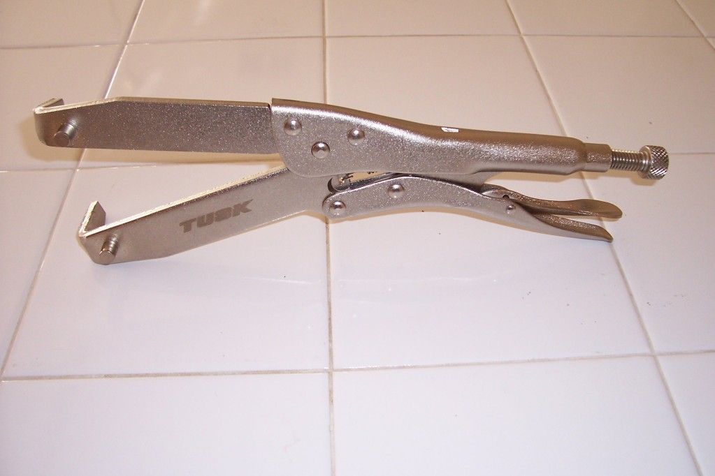

In case you don't happen to have access to an air compressor and impact wrench, here is the tool that I use to hold the clutch boss/basket.
Here is a link on how it works:
http://www.rockymountainatvmc.com/docs/clutch hold instructions.pdf
Brian
