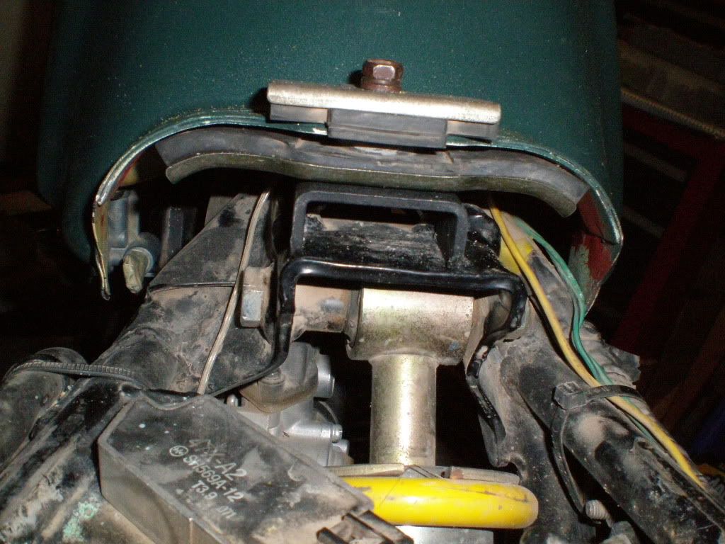

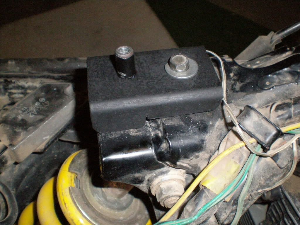

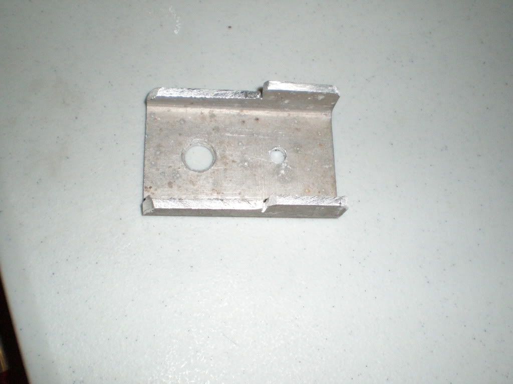

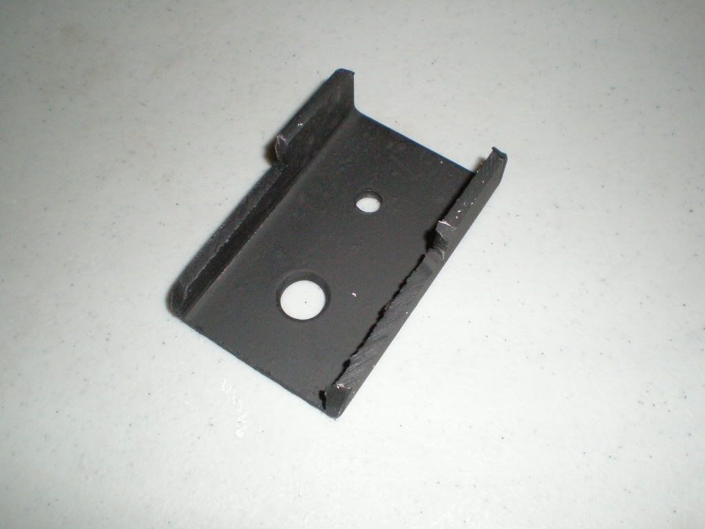

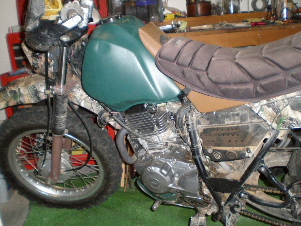

I wanted a larger tank with a locking cap so when parked no one could put crap in my tank. I chose the XT 350 tank (thanks to mrgiz) and wanted to show the almost finish product along with the seat. I still need to camo the tank to match and work the seat a little more. This is a simple way to add 3.2 gal. and I spent $45.00 for the tank.

Ronnydog, Congratulations, it looks good. I used a nearly identical mount bracket for the rear when it installed the xt350 tank. I wondered about it being stable for a few miles, but now after 4000 miles with the xt350 tank in place, I'm convinced its a keeper. I prefer the nonlocking cap - there were too many times when my locking cap was so tight that I was afraid I was going to break off the key just trying to get ahold of the cap to fight it off. I'd lube the gasket and it would come off easily a time or two and then tighten up again. Here in NM folks take things out of your tank and do not usually put things in. I ended up raising my bars 3/4" but I'm not sure I needed to do so. Hows your clearance on the front forks? Too bad metal xt350 tanks are hard to come by. I think it works well. Tom

Thanks for posting the tank mod bracket. I too bought a XT something-or-other tank from Mrgizmow and I like this bracket idea. I can tell by your pictures mine is not a XT350, or the same year. Just finished with painting my frame this morning so I will start re-assembling the TW tomorrow. I will make a hybrid bracket from information provided by Mrgizmow and you.
I also noticed it appears you drilled some holes in your airbox cover and a couple larger vents(?) in the exposed area. Yours are quite a bit more uniform than the random locations I did. I'm going to post a photo I took of my airbox holes for another thread and forum members benefit (can't remember which one right off). I only mention this as I took the photo of the painted tank I got from Mrgizmow. Also, I hope you don't mind, but I will also reference your airbox in the thread.

Tom the clearance is good with the forks, just a slight tap when fully turned. I do like the XT tank but was worried it my be to wide but it turned out to be narrow enough to make the ride pleasant. I am starting a fat tire front build and may have a problem then?

Thats what I felt, a tap, or contact, but no real problem in a full turn. But once I had added the 3/4 " riser to the bars I could not even testify that it was just a tap. No marks on my tank after many 1,000s of miles installed. It was the best $40 I ever spent on the bike. Tom

Its the top triple clamp that is touching the tank. Just a slight tap. My bars are raised with 1.5 tusk bar risers, you can see them in the pic.
