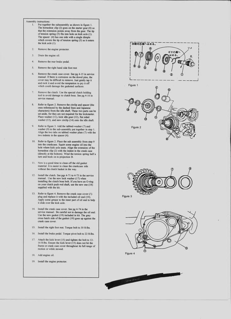

Howdy:
Finally got to adding a kick starter to my 04. I ordered all the parts separately and assembled it using instruction here in our forum. It was pretty straight forward,needed a bit of clarification on the positioning of the friction spring and the tabbed washer plate. This diagram is very useful:
