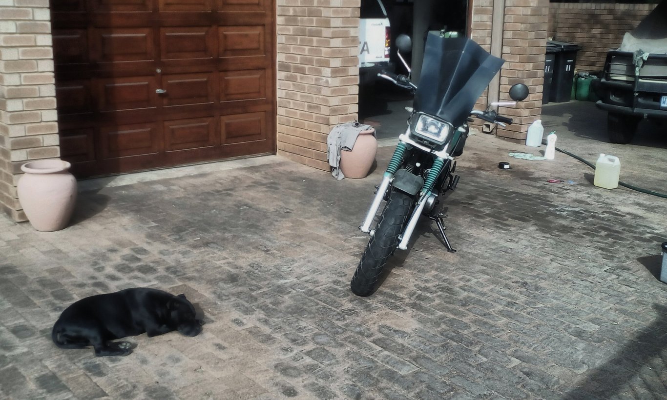

Oh, and by the way, the Cornshield received a proper wash today:cool:
