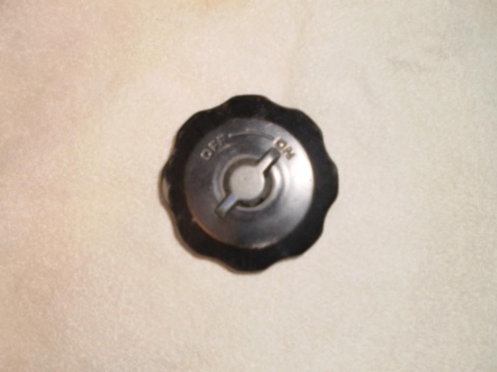

FWIW I discovered that some Honda caps fit the early TW tanks perfectly. This one came from my ATC Big Red, but odds are those from other Honda ATV's and street bikes may fit as well if you're having issues. Some may even fit the later tanks with the small diameter caps:

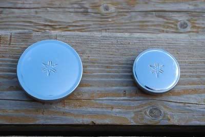

1,036 Posts
They exist, but I don't have any more. But FYI here are the two sizes for older and newer tanks.
They are vintage; I doubt they are being reproduced, but they may have been used over a far greater span of years than any of us realize. My shop guys salvaged a bunch from a throw away bin behind a Yamaha dealership a couple of decades ago.
Proudly display the tuning forks if you can get them. Tom

Finally, I can follow up. I've been at the cabin without internet and other luxuries of life on the grid....but there is a Kubota dealer nearby and I finally got the gasket that was reputed to fit early gas caps. It wasn't in stock but they ordered it and it cost $8. The I.D. is so close to identical to the Yamaha gasket that I can't tell the difference. The O.D. is slightly larger but when I put it on the cap it fits just fine. The thickness is real close but the Kubota part has some ribs molded in. I think that is actually better than just a flat gasket. The lock has been disabled on my cap and it tightens perfectly and doesn't leak when I slosh gas around in the tank. I'll give it a 10.
