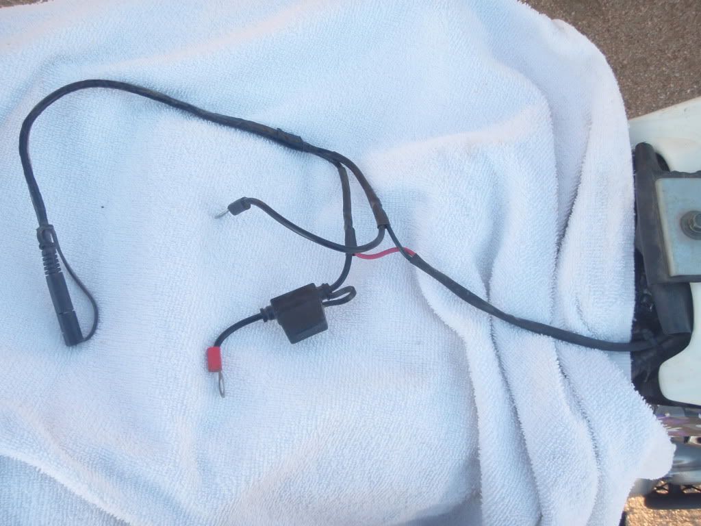

FWIW, if you combine the typical 12v outlet wiring with the fuse and Battery Tender wiring you'll cut down on the clutter under your seat and at the battery terminals as well as the amount of wiring involved. The same fuse will cover the circuit when using either the Battery Tender leads or the outlet as a power source, OR when charging on a tender with only a single connection at the battery:
