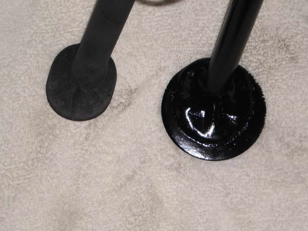

1 1/8" Flat washer, 3" O.D. Galvanizing was ground off on welded side.
7 square in. vs. less than 3 square in. Enough keep it from digging a hole to China.
Early TW "crow's foot" kickstand on the right. Late-model "flatfoot" style has slightly smaller foot, but easier to weld. Longer XT600 stand that I use on my TW on the right. The offset is neccessary for swingarm clearance when in the "up" position.
Actually I'd kinda like to see how others have solved the problem as well, short of throwing a glove under it.
I've seen a few feet made from hockey pucks and such. Put 'em up, if you got 'em.
Great idea! Thanks for posting it.
When I finished up my suspension mods I needed to lengthen the k-stand and wanted more surface area as well. A short section of pipe and some flat stock. The washer is a neat idea as you can do all your welding around the hole on the under side.. Gerry
