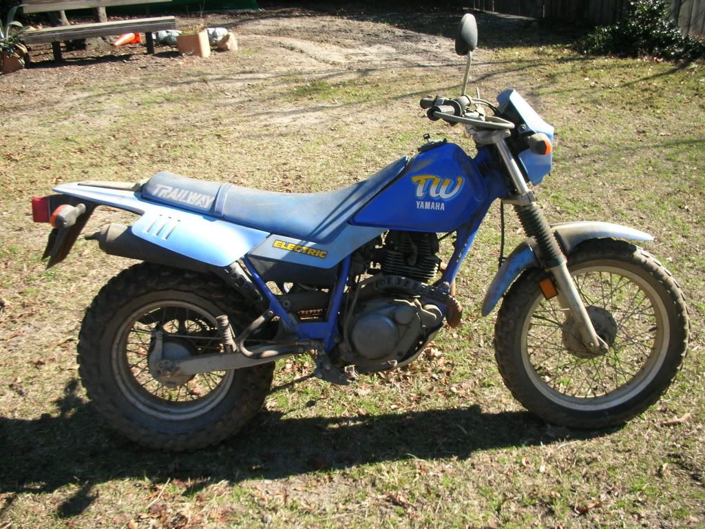

1989 TW200 with 5434miles was about to be sacrificed to the Scrap God's when I heroically rescued him from an untimely demise, and for a mere $100. Everything is there except for the left mirror, tool kit and AIR FILTER!!. He's been sitting indoors all his life and is in remarkable condition. I plan to put a new topend on it and other obvious items such as brakes, bearings, cables, etc. The bike was running a few years ago but smoking heavily. Any suggestions, tips, or thoughts would be most appreciated. Also, I'm thinking about a different color scheme. I don't really want to change the tank, but the frame and plastics are all up for discussion.

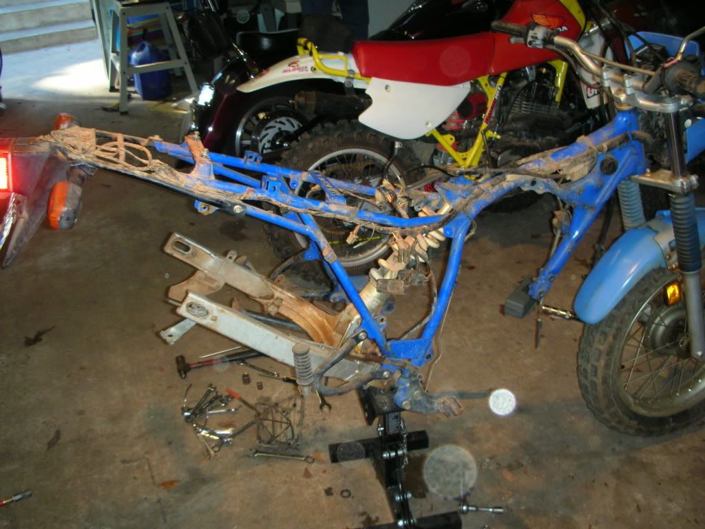

In all serious though, I know most of what I'm doing, but the few tricky spots I snap a photo of and all bolt clusters go into labeled ziplocks. The tough parts not done yet. Getting the wiring harness routed properly during reassembly is where I've seen trouble. These bikes are simple though. Tearing down newer bikes like rockets and cruisers is really where you need ol' Obie.

Rings, valve lap, total cleanout of carb and petcock and tank should see the engine in fine shape. Pump all the cable sleeves with oil, check condition of chain and sprockets, and tires, new battery and you will have a new 89 model prime ride.

The chain and sprockets were new when parked so I removed the surface rust and am soaking the chain in kerosene now. Rear tire is great but front needs replaced. Just finished inspecting and lubing cables. Does the boy need the battery to operate properly or will it run with out? Finally, I can't bring myself to tear it down, put $35 in gaskets on there and $25 in gaskets when I could go ahead and star anew with a fresh bore. It's worth the money imho.
Okay, the piston is standard(no rebore) so I'm looking at a 1st over. I found an interesting right up here that states the Wiseco piston for the yfm200 is a direct replacement and increases the compression to 10.25:1. Can anyone here verify this before I order and test it out?
Also, does the bw200 gasket set fit?
The wire loom routing is in the service manual.
The only real touchy part is the CDI and alternator wires from the left engine side cover. Make sure they're routed within the side cover properly so you don't pinch them.
You may want to re-wrap the forward part of the harness where it passes over the frame near the rear gas tank mount.
Do the dielectric gease thing wire-by-wire on all the bullet connectors, etc.

The o/s piston and cylinder went to the machine shop.
I have sand blasted and primed all the brackets/braces/Swingarm
Today I am blasting/priming/painting the frame and will be ready to start reasssembly
