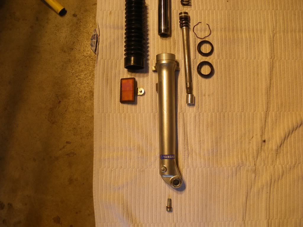

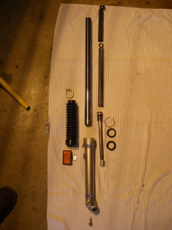

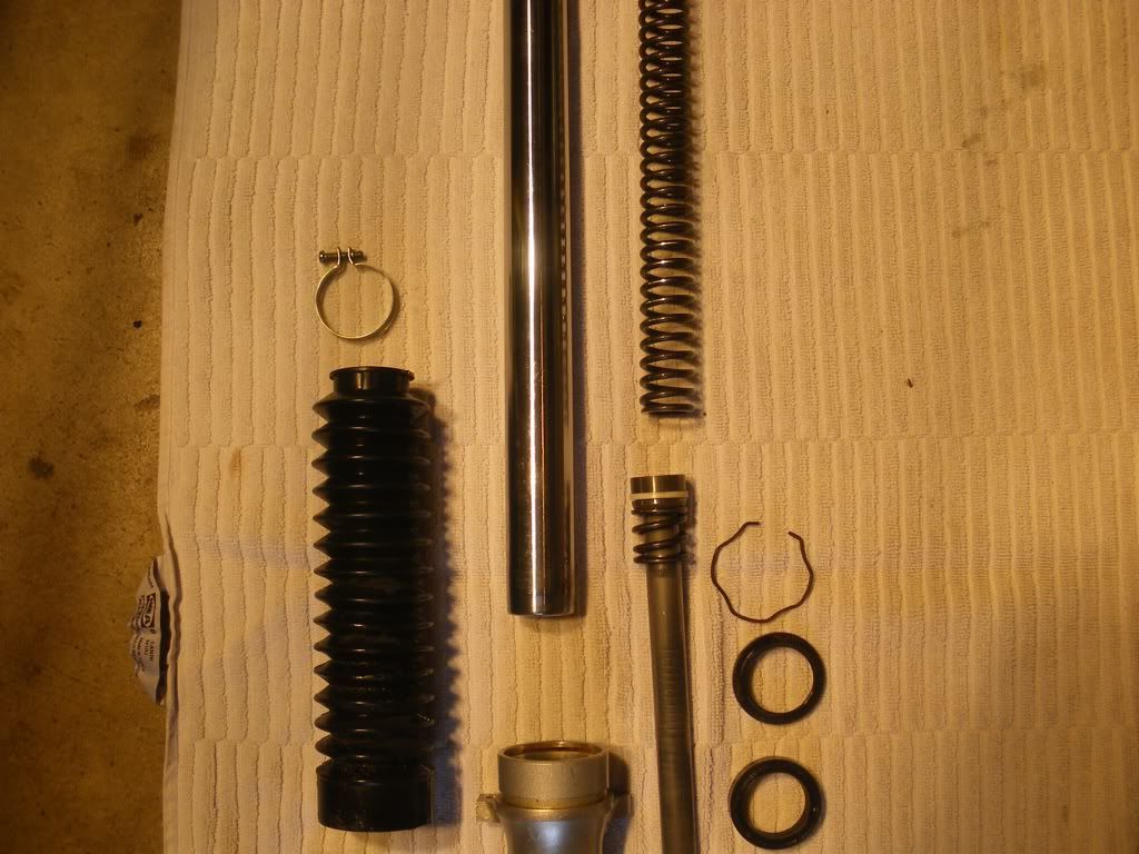

Here are some pictures for you:
This is almost everything thats inside the front fork (theres a bushing thats pressed in the lower tube that I didn't take out):

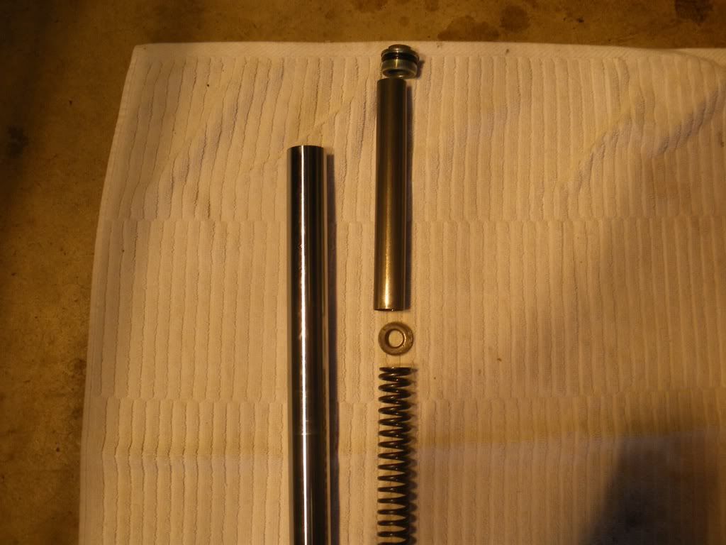

Here is the spacer. Its on the right side, second item down:

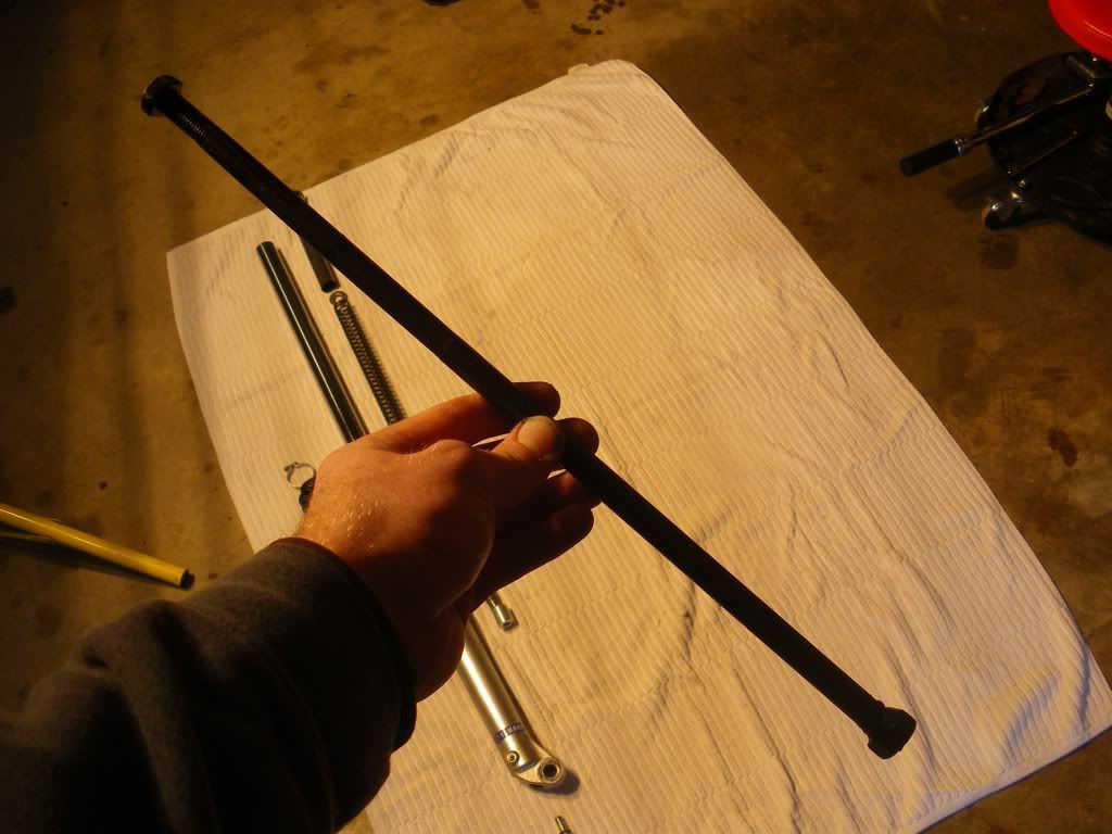

The only special tool you'll need to take them apart is what Yamaha calls a Damper Rod Holder and T Handle. Its just a steel rod, maybe 1/2" diameter with a 19mm hex head on the end. I just took a 20 inch steel rod and had a buddy weld on a 19mm nut on either end. Basically, find two nuts that fit on a 12 mm bolt, and the nuts should take a 19 mm socket.
