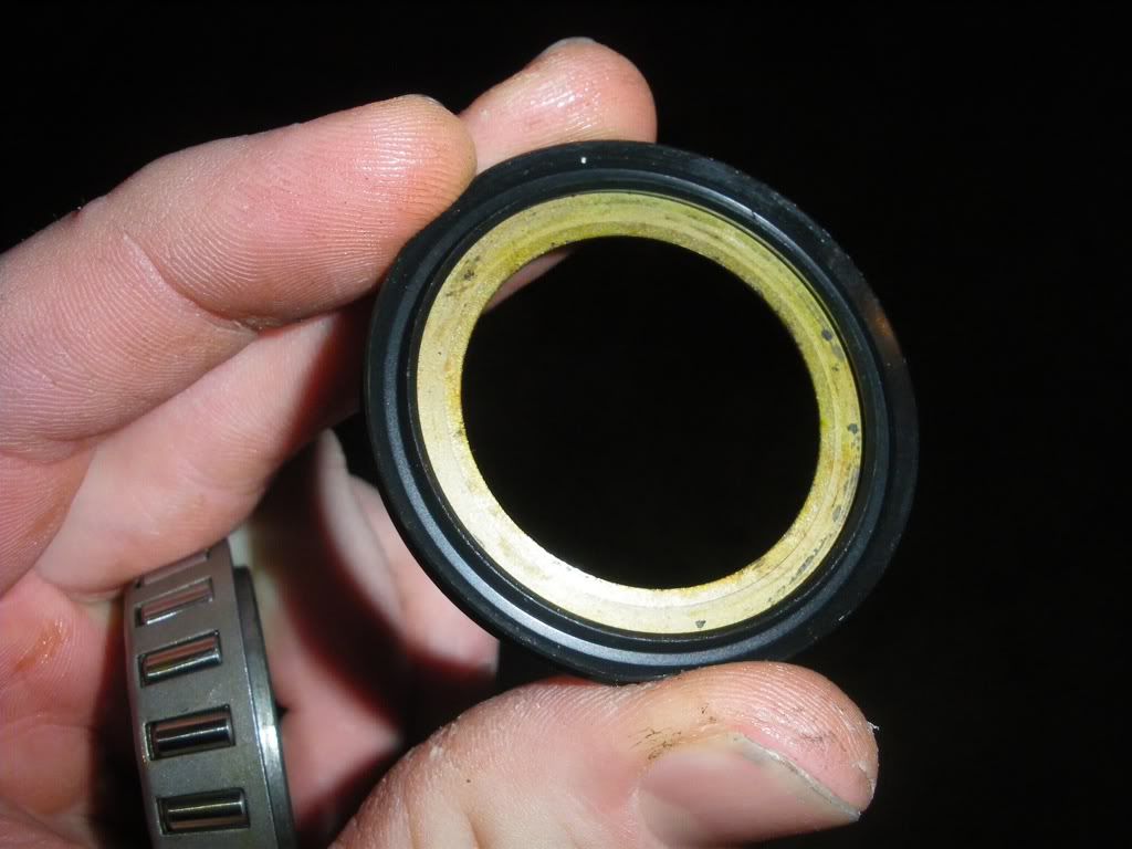

Before I begin the installation of my All Balls steering bearings I would like to ask a few questions so this thing goes smooth.
First question:
When I get the lower race off of the lower steering stem, does the dust seal (black rubber piece at the bottom of the stem under the race) stay on when I install my new bearing? I know it comes off but, do I leave it on?
Second question:
Which way does the new dust seal thing go? Does the recessed/grooved part face up?
Like this:
and this
or does the flat part go up and the recessed/grooved part go down?
Like this:
and this:
Thanks for any help.
438 Posts
I put it U cup up
Normally a U cup is so the higher pressure side uses the pressure to help seal pushing the rubber out
There is no pressure in this situation so there is more rubber UP into the housing so thats the way i used it.
The stock seal will NOT survive the extraction process
