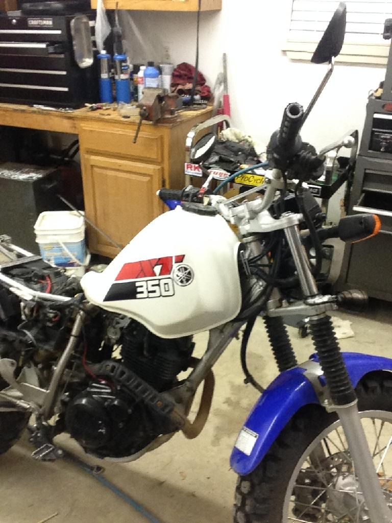

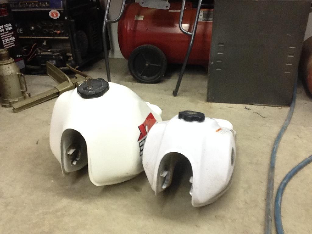

We'll I've officially got a frakenbike. Bought this XT350 tank from a guy up in PA, it's in really good shape except for a tiny bit of rust inside. I'll be trying the pine sol and rock trick to clean it out. Takes my capacity from 1.8 gallons to around 3.2, pretty big difference in range at 75+mpg.

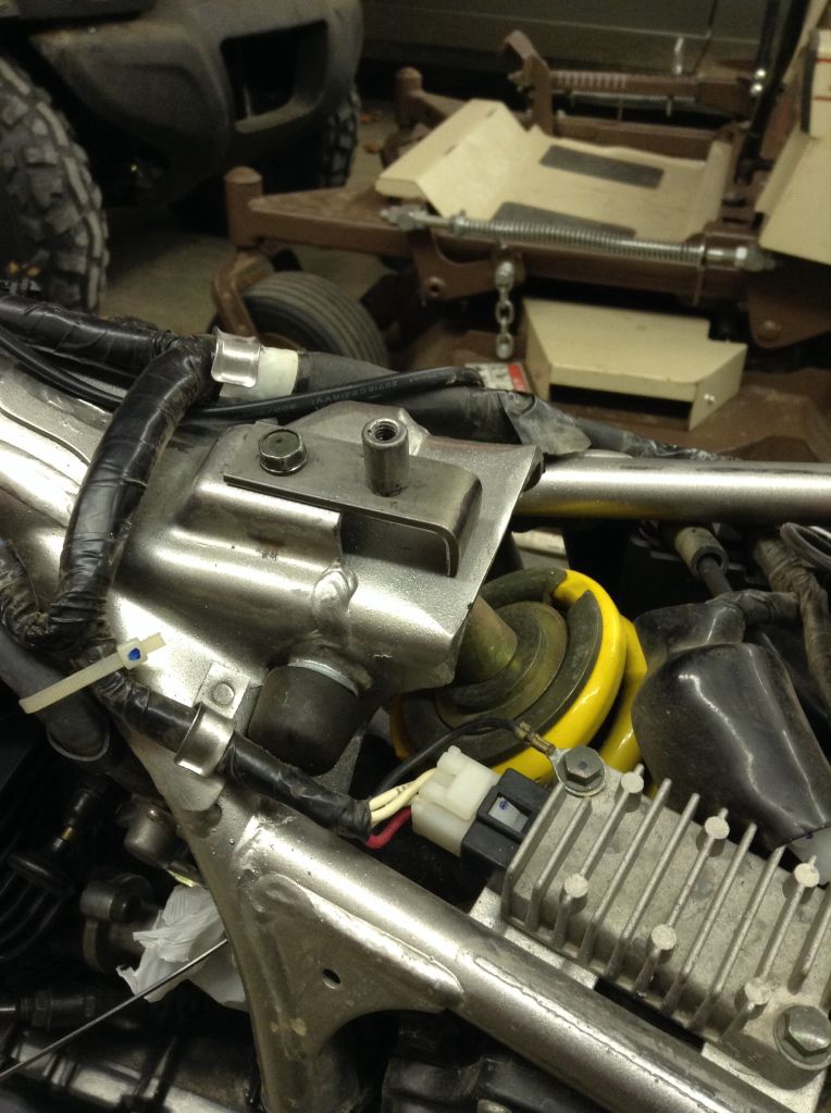

Had to make a bracket that moved the stem back 1". Gonna hold off cutting up the seat, don't feel like doing that tonight.

Nice work on that custom bracket mattmus4357! Very Clean!
Hey thanks! All it takes is some 1" metal flat bar, a vise, and a framing hammer :D

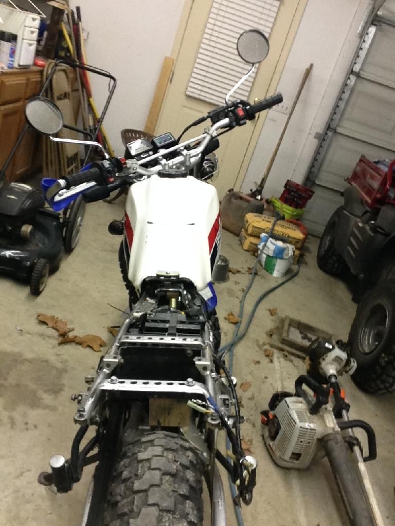

I'm going to throw a few coats of silver duplicolor on it to prevent rust. The installation as a whole was pretty simple. Now I'm just waiting to figure out how I'm going to do the seat. I've considered just cutting it down and cutting some slots to make it more flexible, but I've also considered doing the XT350 seat graft to it. Gotta keep looking at it, the answer will come to me.
