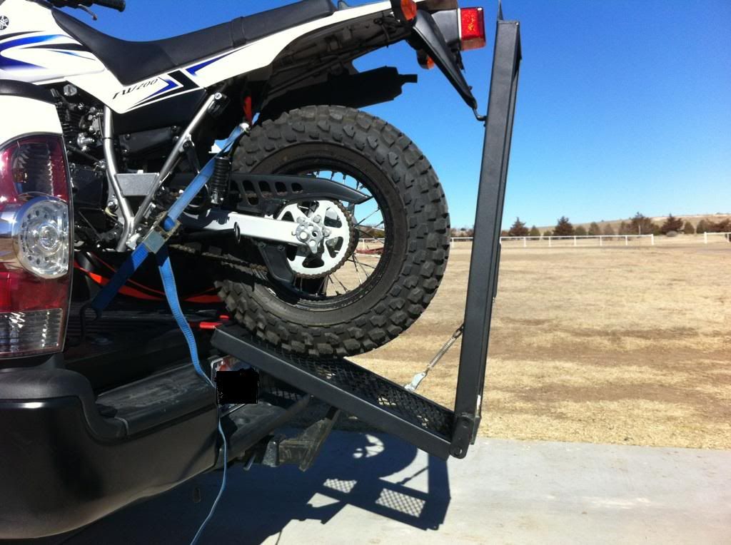

Posted this in the test forum the other day. I just bought my first TW and hauling it in the back of my tacoma with a tool box, did not like the waythe back tire rested on my lite tailgate. I know the actual weight of the bike at the back wheel is not much, but that combined with the force applied by the tie down straps actually made the composite tailgate material bow in. Didnt like it. Built this from a 9" drop hitch flipped upside down, with a modified ramp welded to it. Made the ramp hinge and put a latch on it to hold it in the up position. makes loading and unloading very quick, dont have to worry about the ramp moving while loading, dont have to worry about straping the ramp in the bed while going down the road. And if you will put a lock on the reciever pin you dont have to worry about someone walking off with your ramp. Works for me.

Every owner's manual for every truck I ever owned warned against excessive loads on the tailgates. Different trucks had different limits.
Technically, everywhere I've been plates must be visible and rear plates must be illuminated, no matter what.
Driving with even partially blocked taillights is an unsafe practice. I've seen LEOs ticket people with partially blocked taillights after they were rear-ended. I've also seen people ticketed for not flagging loads that extend more than a set distance behind the taillights.
I like the reciever-mounted ramp idea. I prefer one ramp for the bike and one ramp for me when loading and unloading. Same idea modified to hold a pair of ramps attached to a couple crossmembers would also work, especially since I like to load a single bike off-center to allow more room for gear.
The offset idea is great, You could also do this same idea with two ramps for a four wheeler kinda a offset x2. 1 on each side.
