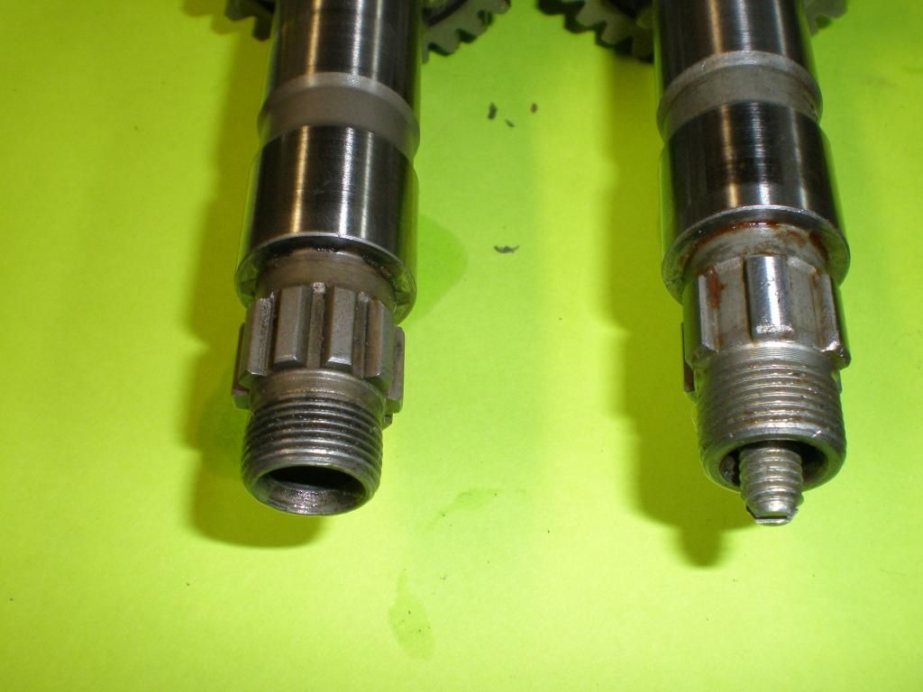

Operose, the shaft spline on the left is the TTR and on the right is the TW. I used the TTR shaft with the 6 speed. I do not know if there are dif years with dif shaft splines or if the XT225 will work. Clutch cover I used is the TTR and it fits.

Thanks Ronny. I've probably dug too deep into the wallet for the bike already this year, so this probably won't happen. Trying to work a deal with mac for a used clutch boss he has in stock.
This should be very useful info for anyone else thinking about the conversion though!
