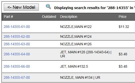

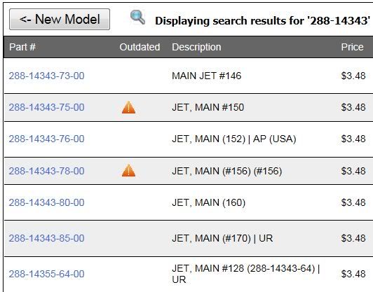

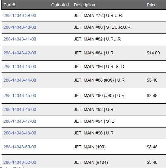

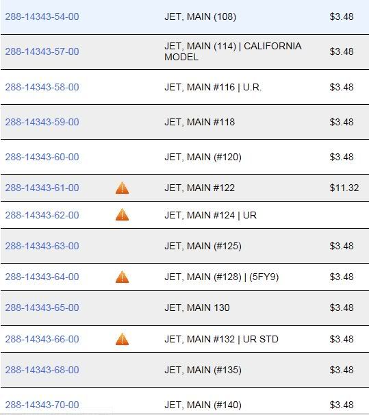

TW main jets are numbered 288-14343-xx-00
Some TW main jet numbers are superceded by 288-14355-xx-00 numbers
Some 288-14343-xx-00 numbers are superceded by or supercede 288-14329-xx-00 numbers
I think we just may have more choices in main jets than one can shake a stick at. Look closely and you can find the #126 and #132.5 main jets that have caused confusion are from the 14355 main jet family, not the 14343 main jet family. Both have worked well for people with the late carbs. Note that the #128 from the 14343 family has been superceded by the #128 from the 14355 family (3rd picture).
