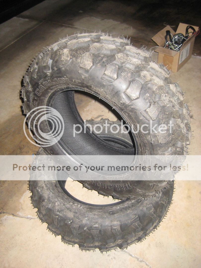

Well, with a little luck, I was able to score 2 Carlisle Terrathon ERT Run Flat Tires (26x8-14) for the rear of my TW. These are 4 ply, 22 psi, real deal run flats.
My plan is to use the stock rear TW200 wheel + a tube + the Run Flat tires - no idea how these are going to mount up.
My bro is a service mngr and a modern auto repair / tire shop, so he will be my first stop. His shop has all the equipment for automotive run flat tires.
Has anyone else in the world of TWs tried this?

Dropped the tire / wheel / tube off at the shop - hope to have good news tomorrow!
Your opinion needed: Should I get this rear tire / wheel balanced or just leave it as is? The TW is no speed machine and I will rarely be taking this on road. Thoughts...?
715 Posts
Discussion Starter #9 (Edited)
The tire is mounted on the wheel! It took extra lube and 70psi to seat the bead.
The shop had issues seating the bead (took 3 days) but was able to do it without trimming anything off the tire.
The max pressure needed was 70psi which is quite high. I am using a HD tube and the tire has super thick / super stiff sidewalls, so a high pressure should be ok.
I'll get it mounted on the bike this weekend and take some pics.
Thanks for all the help - great info on this forum.

No drama for me and tires - Back when I was an auto tech, I saw some neat tire explosions, I'll let the pros handle it. :cool:
Good point on the re-gearing. I'm going to try the stock gearing, if it sucks, then I will re-gear.
I don't know much about run flat tires other than a google search - maybe someone here does?? Carlisle doesn't list any specs online about the Terrathon ERT, I also emailed them for specs but didn't get a response.
The bead, sidewall and overall build of this Carlisle Terrathon ERT is very thick and stiff. If I were to compare it to an automotive tire, It would be like a load range E truck tire. IT IS HEAVY and the sidewall has virtually no flex.
YES- tube is still needed for TW, only because the tire is mounted on a laced wheel. The military applications uses ATV / automotive style wheels where no tube is needed.
More info coming when I get it mounted on the bike. I'll post circumference, tire weight, and when I get a chance, a ride report.
Thanks for the help dudes!

OK - done and done - WOW
Air optional!
Quick measurements: 27" height and 85" circumference. I measured it aired up to 40psi, I will needed to recheck at 10psi, sorry.
This tire has a nice round profile which is very similar to the OEM tire.
Handles normal on tar and gravel. This thing blasts through the deep snow, I was not expecting that.
Excellent handling on road even though it is not balanced yet. I will be adding Ride-On when the temp is warmer (15f and snowing here today)
Lots more noise on road - definitely not a good choice for on road driving because of that.
Gearing - I didn't notice a big change, I am using the OEM gearing. With the larger tire, stock gearing is more usable for gravel road / dirt driving. I liked the change over the factory gearing. I have an open muffler and re-jetted.
The only modification was trimming the plastic chain guard a little, other than that, it just slipped right in.
Now I understand the HUGE traction improvement over the stock tire.
Kickstand optional:
