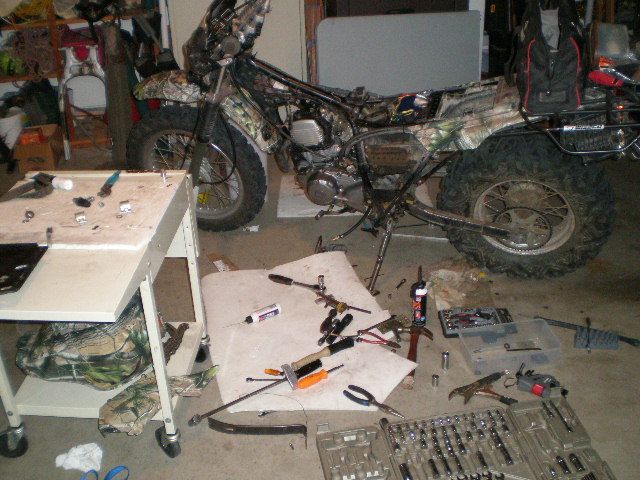

I started out with the Tw 200 and yes it can be done again. I tried to use all the TW parts I could so it could be done by others on the site. I took my first ride and there is a lot more torque a smile factor for sure like the bike is 150# lighter. It is running a little lean and stumbles at 3/4 throttle right now. I need to jet it before I test it again.
As for the 6 speed...1st and 6th feel about the same as 1st and 5th on the TW. Having 2,3,4,5 in lieu of 2,3,4 definitey keeps the bike in the power band, at least for now that is what is felt. Kind of a odd felling down shifting 6 gears on a TW when you are used to 5 for so many years. That is a pic of the 6 speed ready to go into the TW. More testing to come.

Holy smokes, now that is super cool. BTW I started my own build thread, and it's been super hard to keep momentum going on the build, life stuff (my job) really jams things up. Haha! SO I can relate.
So is it a stroked 200? Do you mind giving the basic details here on this thread?
Really cool work man!

I am happy to share the build and pics it just takes me a little time to put it together.
Yes stroked 200. The stock TW is 67mm piston X 55.7mm stroke=196cc the new build is 71mmX62mm=245cc. That is the longest stroke I could go and use the stock cam chain. http://crankworks.com/index.php/contact did the rebuild on the crank with a TTR 225 rod.
