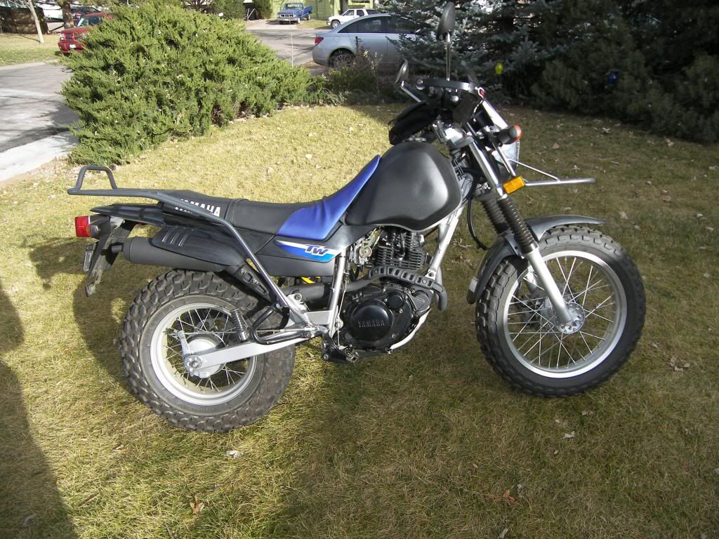

I finally got my XT350 tank de-rusted, painted and installed. :) I believe the tank is a 1999 CA model.

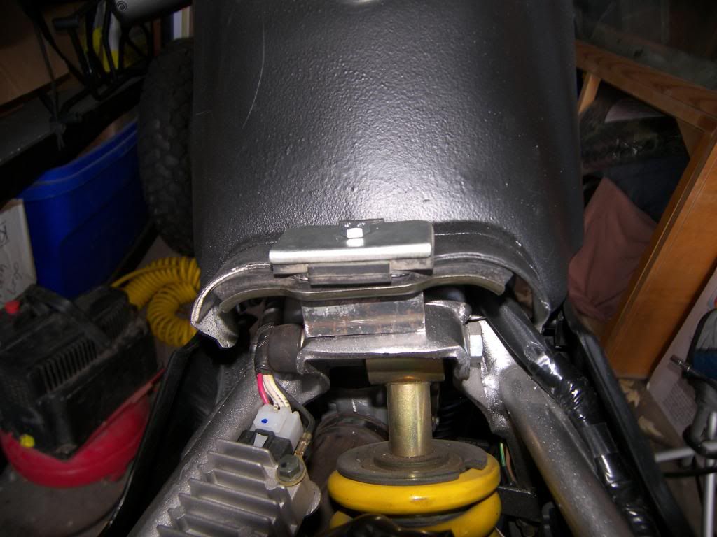

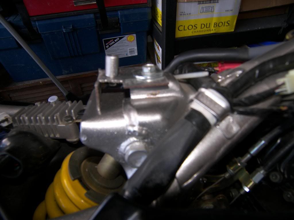

The tank mount:
I bought spare XT bushings from ebay for the mount hardware - $15

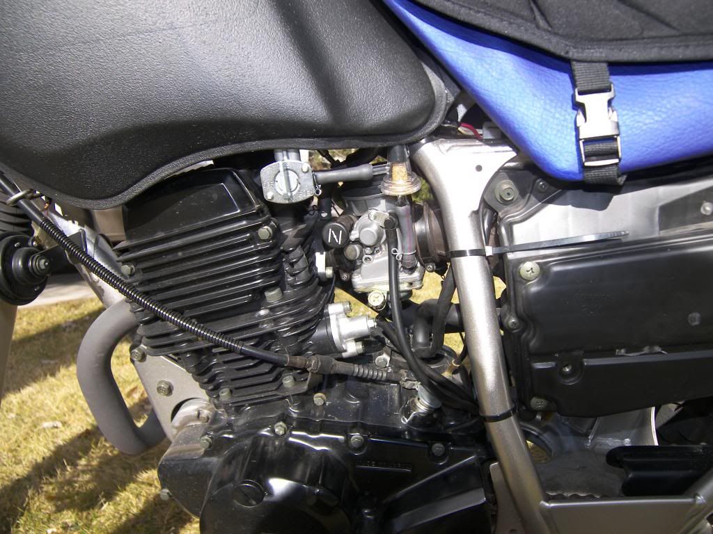

Fuel filter in place, ebay petcock (New Genuine Gas Fuel Valve Petcock 1994 2012 Yamaha TW200 TW 23F 24500 11 00 | eBay) clears everything nicely.

I think the tank fits the lines of the TW very nicely, and the extra fuel capacity is most definitely welcomed.
